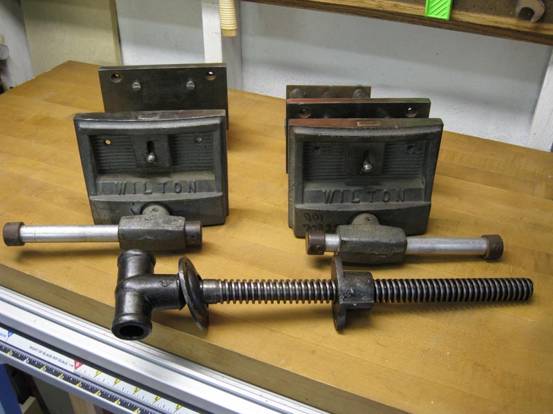

    I've been needing to make myself a decent workbench for some time. Just recently, I procured a decent bench screw. I already had a cheap Big Lots 9" jaw 10" opening quick release (cheap import, just like the HF). I also have a 2" thick glued up 2'x4' slab of maple I rescued from a dumpster a while back. Yesterday I was given a pair of Wilton 7" jaw 9" opening 4" depth vises.
    Before those Wiltons came to me I was thinking about using the screw for either a tail vise like Klausz' design or a leg vise. Just figuring out the tail vise in CAD wasn't easy. I think building it would be even harder. That screw isn't really made for that application either. My wife got it from an old welders bench where it was in service as a leg vise. It took me a couple hours with a wire wheel in my grinder to get it cleaned up.
    I've been working with some designs to be able to fit my flip top planer cart under the bench, as there isn't too many other places for it to fit. Right now it could go on the end wall, but a mobile bandsaw and a rolling dust collector will be going in there someday.
    My shop is tiny, as in 10x12 shed tiny. The space abailable for the bench will make it 5', maybe 6' long, probably 30-32" wide. I'm now thinking of mounting one of the wiltons as a face vise on the far left, a nice wide leg vise on the right leg face using the screw and putting the other wilton on the right end (a bit towards the front). I'd love to get one of the veritas twin screws for that end, but I can barely afford the money for the wood to do the bench as it is.
