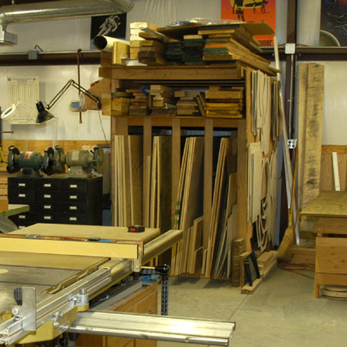

                My wood rack is not on wheels, but could have been. Maybe you will at least get an idea or two from this photo.

                    Tom - that's a nice setup. How deep is the storage system? Also - what kind of saw is that? I see it has a really solid looking SMT.
                      Since sheet goods are 8'long, that is how long my rack is. That also makes it convenient to store lumber.
                      The saw is a late 80s Powermatic 66. I found the sliding table I wanted at the Atlanta woodworking show, and bought a used PM that it would fit on. There are nice ones available today, but this is the first one I saw that would cross cut 48".

                        Thanks - the rack is also much bigger than I had expected. At a glance, I thought it was for 1/2 sheets or Baltic Birch 5x5's. Very nice!
