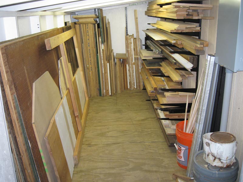

      I don't really have any specific answers for you, but I used a similar bracket from Lowes in my storage addition.
      I just located the vertical bars 24" OC to correspond to the studs I was screwing them into. I did find out that the vertical supports don't take impact loads very well. After I had all the brackets in and loaded I was moving my plywood in on the other side. Two pieces of 3/4" PT fell over and bent down a couple shelf brackets. Actually the brackets were fine, the support bent in.

        I cant quite tell from the photo but are they approx 8' bds and do you have 3 or 4 supports?
          Most of the boards are 8' some 10'. There would be 3 supports for the 8' lengths. I hang the stock off the ends of the brackets 1'.
          I lost a little space going with more rows of shelves, but I find it easier to locate and access materials in smaller stacks. The bad thing about these types of brackets is the height of them. You end up using about 2-1/2" per row instead of the 3/4" or 1" thickness I've seen on higher end packages or DIY pipe supports.
