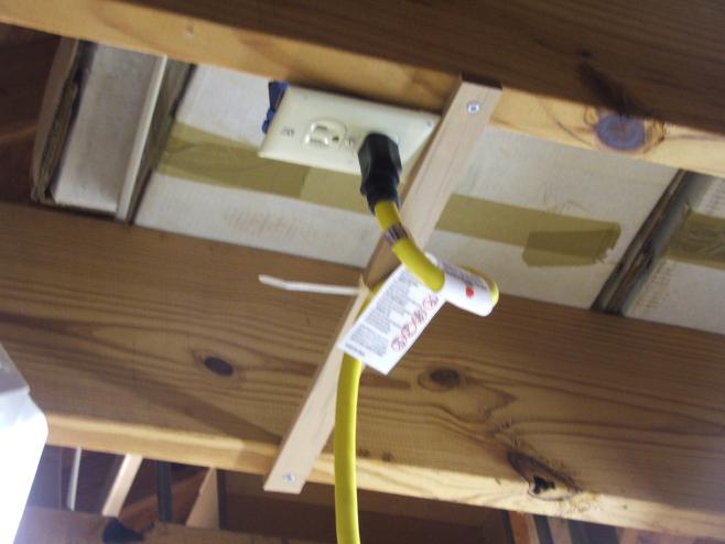

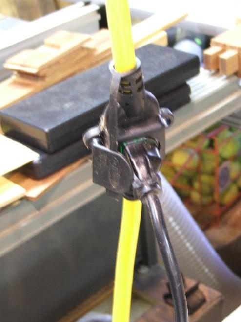

                              #44
                              One for the TS, overhead dropped down using one of those $10.49 extension cords with four outlets and green LEDs spaced every 8 feet.
                              Loring, I thought it was "frowned" upon to use cords? Is this just a shorty to save getting out a ladder every time you want to hook something up?
                              What GA did you use as I want to do the same thing. I about to go out and look but can you get one of those curly ones so it will add some strain relief just in case you snag the cable?
                              Also didnt you mention wiring in some extensions e.g. for moveable shopcart or bench using the same 12-2?

                                #45
                                Nothing is ever totally bad or totally good. People who don't understand usually want a yes or no answer, though.
                                I chose to locate the power outlet near the center of my garage.
                                I can mount an outlet in the ceiling or I can set up a permanent pole attached to the floor (like a 2x4) and the ceiling and mount an outlet to that. That tends to be more permanent and inflexible.
                                So I chose the ceiling mounted one. Now the problem is do I want to plug the saw into the ceiling... would it be inconvenient to have to get a stepladder all the time.
                                So I want to use a flexible extension cord. At HD late last year they had these 24 foot, 12-3 ga yellow cords. It had four outlets, one every 8 feet including the end. So if the saw is on the first one, then its only like an 8-foot extension cord. Since its 12 gauge there's no more resistance than if I ran an extra few feet of romex down a permanent pole.
                                What's the objection to extension cords?
                                one, generally people use a max of 16 ga. extension cords like 25 feeet long, adding a fair amount of resistance compared to a minimal amount of 12 ga. in-wall wiring.
                                2, they add a bit of resistance at the plug.
                                3. they are a tripping hazard
                                4. when excess length is coild up and current flows in it, it can overheat
                                Since mine is overhead and 12 ga., none of these problems apply except #2 so I don't really think I have compromised much. The extra 3 outlets can power additional items in the center of the shop as I need them.
                                I'm not sure what else you were referring to. I think I said I might add some additional romex to one of the circuits for a convenience outlet farther down that wall.
