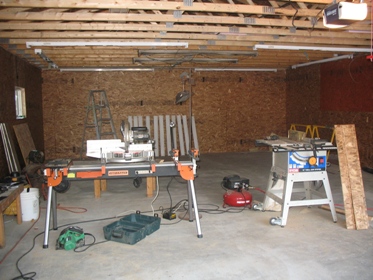

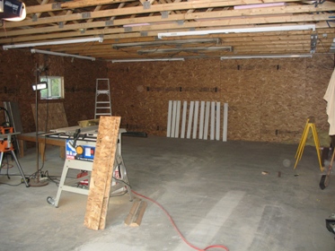

                              Here is what I decided on - my work area will be about 20x24. I went with a rectangle layout with my four bulb fixtures over the main work area. This should leave me with a light over every bench/tool. I have one extra fixture which will be over the radiant heat manifolds and associated hardware.
