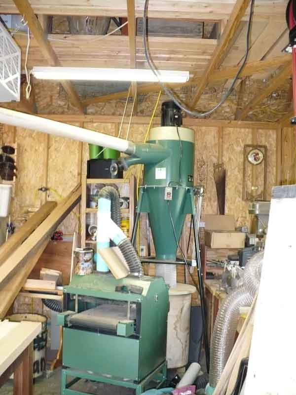

Broke ground on new 4' x 4.5' addition to the shop for DC storage. My goals are to 1) increase floor space 2) decrease noise 3) decrease dust and 4) make chip dumps easier. I am planning on adding on a much larger addition or purchasing a detached shed later this year for lawn equipment, bikes, storage etc. I contemplated dividing off a section for a DC room but decided against that idea. As such I am adding 4' x 4.5' room to the back of the shop.
Headroom for the tall cyclone is a concern, so I will be digging out the foundation a little. Additionally, I need to be able to fit in there to switch from exterior exhausting to interior exhausting. My plan is to be able to reclaim heat and air during those extreme months by routing the exhaust back into the shop and using the 1 micron bag that came with the unit. During non-heated and ac months I will switch over to exterior venting.
Luckily I will be able to use the hole that I cut in back of the shop for exterior venting as a opening for the main duct run. I plan on running 6" mains, drops, etc to newly constructed 6" dust hoods for TS, jointer and planer. I will use a 6" flex to bandsaw where it will split to (2) 4". This flex will have a quick connect which I can move over to my SCMS station.
