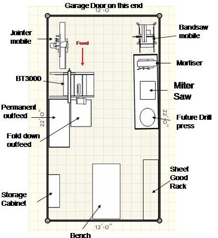

    2)In my shop (see attached) I have a garage door on the end where the saw is located. The small wall next to the door causes me a problem when trying to rip anything wider than 15” and longer than 6’. I could just pull the saw out from the wall but space is tight. Is there a better layout I should consider? (switch the saw to the opposite side or rotate it 180 degrees)

        2. For long, narrow shops, positioning the table saw as you have it, with the right end against one of the two long walls, is usually the best choice. I agree with Keith that moving it "down the page," to equalize the infeed and outfeed areas, would likely result in a better overall arrangement.

          I have a similarly sized shop. My BT is currently oriented with the left side against a wall. I do not like it that way. You have it in the correct orientation.
          If you don't have an easy-to-use mobile base under your BT, you should get one. I have one and it is a two-second problem to move the saw the one or two fee necessary to free up some room.

            I have a fairly small shop (1 car garage sized at best), and used to have a TINY shop. Regardless, I've designed around NOT moving the TS. Almost overything in my shop is mobile, and many things get moved, but I find the TS is such an essential tool that moving it all of the time would be a pain.
            TS, BS, and Lathe are all fixed position, everything else is mobile.

              Keith, can you provide a layout of your shop? I think it would be helpful to see. Thanks.
              -Dave

                  Here is a rough idea of what my shop is like. I didn't go measure things exactly, but you should get the ideal....There are lumber storage racks above the drum sander and planer, as well as one for shorts above the lathe. Sheet goods are purchased as needed, and stored behind the SCMS and DP. The wall by the assembly table has shelved and clamp rack storage, as well as some peg board.

                    Looking at your layout I wonder if you could possibly rearrange things. Is your sheet storage on wheels? If it is could you move it to where the storage cabinet is? Then you could place your table saw so that the blade is centered in the space, giving you a full 10' infront and behind the blade.

                      - I have considered moving the saw towards my bench but like having open space around the bench. That open space is usually my assembly area.
                      - My sheets good rack is fixed to the wall on one end. Imagine it as a door hinged in the corner. With this set up I can pivot the "door" out from the wall to make it easier to get at. I store sheet good on end 4' side down 8' vertical.
