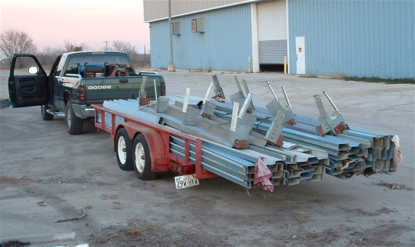

                        Wednesday evening. The only thing standing are the end frames and one purlin that has some of the angle iron from the pipe supports welded to it. The bolts are loose on the prulin and the corner joints have one bolt holding each one.
Name:	Wednesday Night.jpg
                        Wall panels loaded for the trip home.

                        Should be able to get the rest of it down today (and home if I can get a longer trailer), pull the lights from the main building, and salvage/bag enough insulation to cover all the walls.
