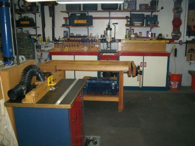

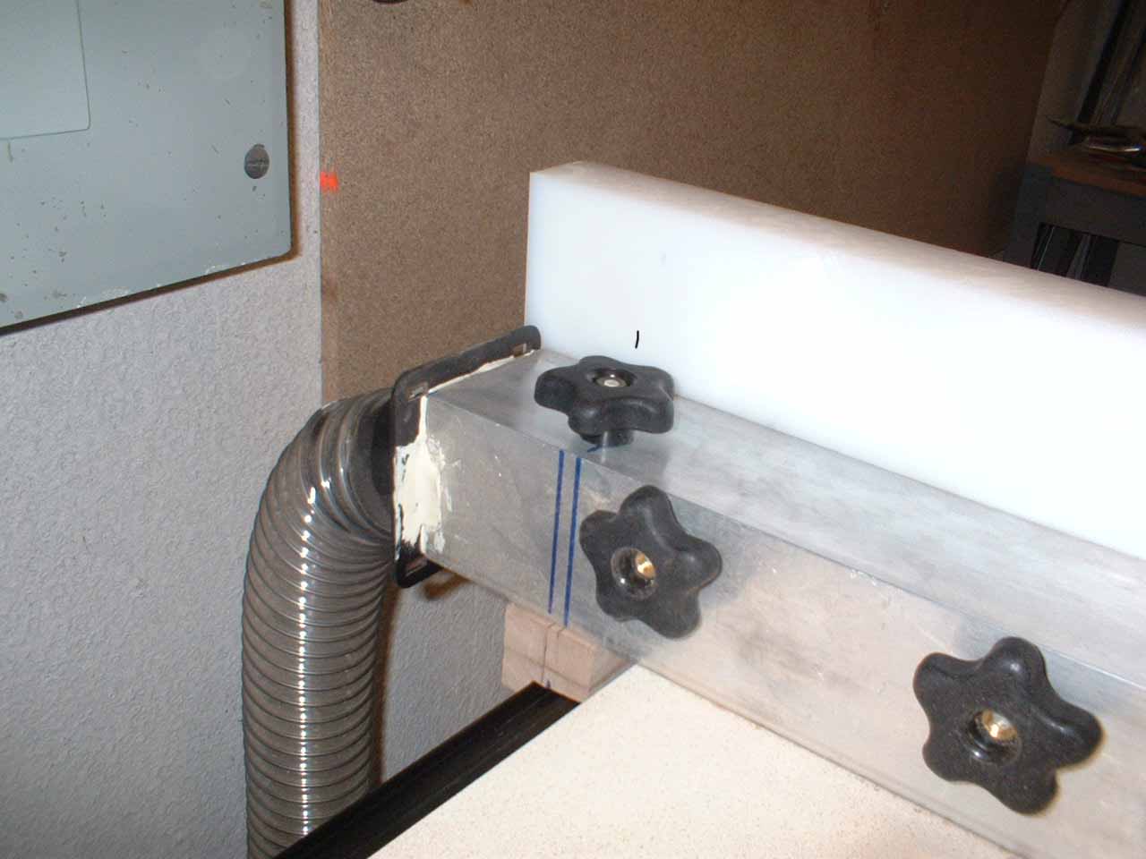

      Check out Frankenbase Lives! Post in the BT3 related discussions. I just completed it yesterday and posted some pics.
      I used MDF through out the cabinet. I used a laminate for the router table top and for the downdraft table. Home depot sells small sheets for like $11 so I used that.
      Also check out what I did about a fence. I just used 3x3 inch square tubing and some plastic not too fancy, but the tubing allows you to suck air from within the fence itself.

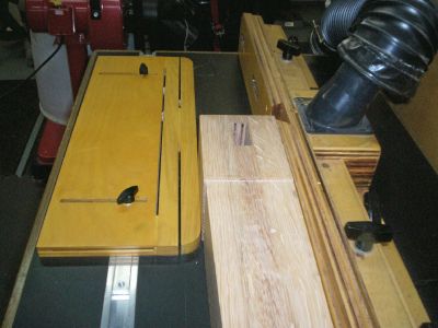

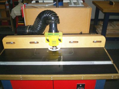

        What a lot of us call a "router table" is really three entirely separate animals, combined into a single unit. There's the top, which supports the router and the workpiece; there's the fence, which locates the workpiece on the top; and there's the storage unit that the top and fence just happen to be sitting on.
        For the top, I agree absolutely that simpler is better. I'm in the same camp with Bill Hylton and the Rosendahls: no miter slot, no fence adjustment tracks, and offset the router toward either one end or one side of the top so you can move around and work off the other end or side when dealing with larger workpieces. How the router mounts is mostly a matter of convenience. Bolting it directly to the underside of the top is cheap and simple, but may or may not make height adjustments and bit changes more fussy, depending on the router; and it will almost always preclude the possibility of closing down the opening around smaller bits. Plates and lifts definitely have their drawbacks but overall I think these are offset by their advantages.
        For the fence, it can be as simple or as elaborate as you need. Many woodworkers, including myself, have both a simple "stick" fence ala the Rosendahls and a more elaborate, multi-adjustable fence ala NYW or even Pat Warner. In many shops, router table fences are always a work in progress: there's always something that's going to be incorporated into The Next One (this is certainly true in my shop). To me the only critical issues are that the fence be straight, and that it attaches out at the overhangs of the top. This automatically maximizes the length of the fence, and gets rid of the adjustment tracks or slots in the top.
        For the storage cabinet all this sits on ... go crazy, build what you need/want. Except for the dust-collection compartment, this part of the table really has no direct influence on what's up top. And it's what's up top that matters most.
