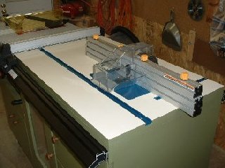

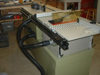

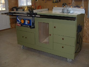

                  I'm almost finished with a router table/table saw side by side that I found photos of somewhere on the internet and copied. Once I get done I will proudly display it for all. Here are the photos I used for my design. They are small so sorry about that. Perhaps it will help.
                  I built mine on the cheap with mostly lumber I had on hand. The router table top and fence is melamine (low cost), with a router plate insert, T-Track, and miter tray from Rockler. I think I paid around $60 for all of that. Also a router remote Start/Stop switch, Rockler had it on sale for $15 bucks. So you definitely don't have to spend a lot on this.
                  Please don't make the mistake I did and put your T-track in the table. Put it at either end of the table and flush or below. When I work with longer pieces at the router they catch on the T-track/ cut in the melamine board which potentially can ruin what you are working on. Feel free to post any questions and good luck!

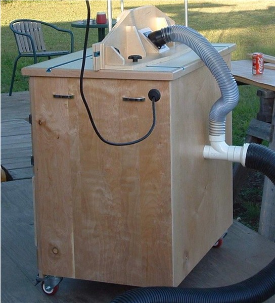

                            Mine is a modified version of the NYW Router Station. Dust collection is fairly good except when routing dados. Biggest changes I made to the design were in the drawers/storage.
Name:	Router station front.jpg
Name:	Router station DC.jpg
                            The plate has been changed to a Woodpecker Plunglift since these pictures were taken. Worth the investment.
