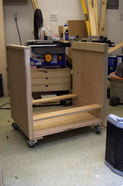

          Well, I'm almost done, and feeling a bit depressed. I am beginning to hate this mobile base. Sooo many mistakes. Where to begin?
          First off: I assembled the sides and bottoms first, without thinking about putting in the stretchers. Now I realize I should have had the stretchers ready to go in before assembly. Getting that fitted in and still serve its purpose will be a bit of a challenge.
          Even then, everything else was going swimmingly. I even managed to put in the stud casters from Rockler. After the sides and bottom were put together, I stepped on the base and hopped up and down to see how stable it was. So far so good, and I was starting to feel pretty good with myself.
          Until I started drilling the holes for the pivot bolts. I picked up the wrong Forstner bit, and instead of drilling a half-inch hole to hold the bushing, I used a 5/8" bit. I almost had a heart attack when the bushing fell through the hole. So I had to hunt for a bushing for the bushing (that's not a stutter). Found one, although it was a pretty tight fit. Now, I normally don't want to use a hammer in these projects because it's so, well, unelegant. But hammer it I did, and finally got the smaller bushing to fit in the bigger one.
          Then I realized that when I was cutting the parts up, I didn't account for the washers that were going between the flip-top and the sides, so the top fitted exactly between the sides. Out came the power planer and the sander because I had to trim the top just a little bit. After a bit of contorting, I finally got the top bolted in.
          As I was installing the barrel bolts, I realized that an important part is to have the front of the top flush with the sides. I was off by 1/2" (the top is a full inch narrower than the sides - another long story). So I got some scrap 1/2" plywood and basically shimmed the bolts.

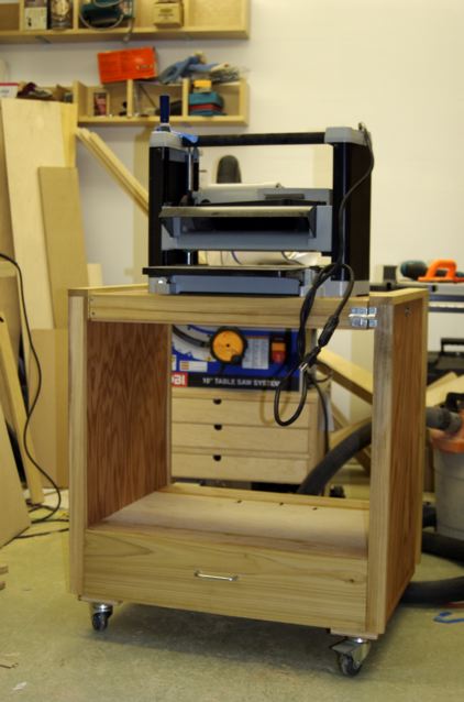

          Then I put the planer on the top. I couldn't wait until I put in the stretchers because I really wanted to see how it works. There were a couple of mishaps with bolting the planer to the table top, ending in several random 3/8" holes on the top, but I did get the planer bolted down.
          So I tried the flip. Well. Let me just say that the planer's weight is not evenly distributed, which I should have thought about to begin with. But it was 10 PM! Oh, well. There was a near disaster when the top swung away from me because, as we all know, the back of the planer is heavier than the front. Nothing was damaged that I can tell. But then again, it was 10 PM, and maybe my eyes were functioning just as well as my brain, which means they weren't functioning very well at all.
          As of 11 PM last night, the whole assembly was still standing, so that's good. I should get back in there soon to finish up the stretchers and whatever, but I'm almost afraid to open the shed's door and see a collapsed table and a disjointed planer on the floor.
          And by the way, I think the Delta TP-305 is too big and heavy to be used on a flip-top base. So I guess I'll end up with a 10" rolling base for it after all.
          Anyway, pictures so far. Pardon the messy background. Some of it is due to a lack of storage. Some of it is due to just throwing things around when I'm, uh, unhappy.

                Thanks. Today wasn't so bad. I finished the edging for the "front" and the stretcher for the "back." I put those words in parentheses because I inadvertently turned the base around while I was working on it and I put the edging on the back and the stretcher in the front. It's a minor detail, and considering all the other things that have gone wrong and could go wrong, I'm counting my blessings.
                Next step is building the drawer for the front. The cool thing is that with the stretcher in place, the base doesn't rack (rock?) anymore, making me feel a lot better about its stability.

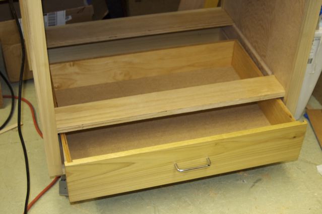

                    Okay, here's the "final" version. I managed to wedge a half-inch plywood between the two 3/4" pieces that formed part of the "shelf," and that finished that. I'm going to put the same stain on it tomorrow that I put on the rest of the oak plywood.
                    The drawer took me five hours to make, mainly because I kept changing my mind about how to build it. I didn't want to use drawer slides, so I used tempered hardboard for the bottom of the drawer. I dadoed the front and rabbeted the back to accommodate the sides, which is the first time I've done that (this is the fourth drawer I've ever built). Someday, I'll try the sliding dovetail technique.
