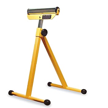

              there's some relatively inexensive troller stands out there, I would thoink making your own, esp. if you have to buy rollers or ball bearings, would be much more expensive and less satisfactory.
              I find these pretty good, $25-35 sometimes on sale for around $20 each...
              Crawford WM5 Work Mover Stand
              ball bearing rollers and heavy enough to stay in place, easily adjustable and folds away neatly.

                        A heavy workpiece can indeed try to tip the Ridgid flip-stand over, but if anything the typical roller stands are even worse in this regard. I have a Shop Fox roller stand, bought cheap off eBay, that appears essentially identical to the one Loring pictures, and very much like those Harbor Freight and the woodworking stores like Woodcraft sells. It weighs about the same (at a guess) as the Ridgid but is less stable due to the narrower "stance" of the legs. Overall, the Ridgid remains the best thing I've found.
