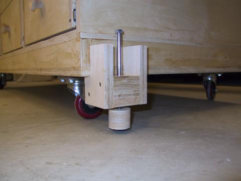

    My BT3 mobile base is highly mobile, and very solid once in position. I chose not to rely on locking casters -- haven't come across any yet that lock well enough for my taste -- but rather, I use four swivel casters in conjunction with a couple of these:

    They're homemade leveler feet; new and improved version utilizes eyebolts that can be turned by hand. There are two in front, one on each side, and they make the unit VERY solid, and allow for all four points of contact to be equally loaded.
    More info here.

      various types of "mobile bases" for tools allow movement but then allow the tool to be firmly planted on the ground by various means of lowering at least two corners to the ground to be off any swiveling casters.
      One popular mobile base is made by HTC and sold on Amazon.
      Other designs have been made, one posted above to lift the tool or bench so that it is stable.
      Thetrouble, esp. with swivelling casters, is that the bench rolls away or the offset swivels rotate allowing the bench or tool to move when you apply any down or sideways pressure, thus leading to accidents and misfeeds. Even if you have locking casters. BTW some casters lock in both the rolling and swivelling directions, making them more stable.
