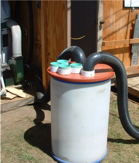

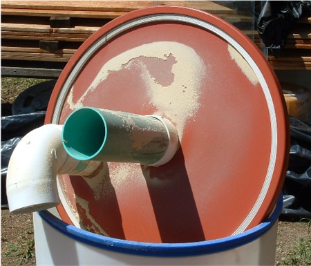

                From another point of view, I have a small shop and I use the GMC closeout DC from Lowes(claims 450 CFM). I upgraded the 30 micron bag to the 1 micron from Grizzly which really help with dust in the air but the CFM degraded pretty fast as the bag filled up. When I moved into my new shop I built a frame that has a 30 gal trashcan with seprator lid from Woodcraft on bottom and the DC sitting on top. I think it works great, the saw dust and chips endup in the can and not in the bag so performance doesn't degrade and the can holds lots more dust before having to be emptied. I'm very happy with the trashcan lid seprator.
                DonHo
                Don
                  Don't like emptying the DC bag more than I have to.
