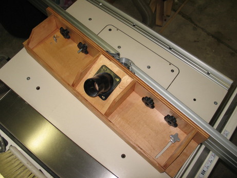

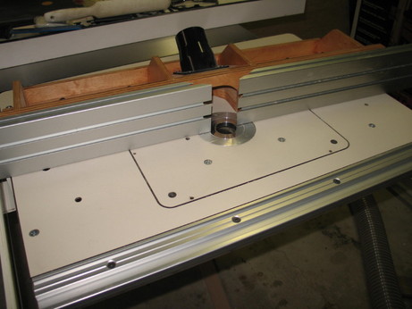

    tlt,
    Here are a few pictures that were sent to me by one of our forum members a while back. If you look closely it is a homemade fence modeled after the Sommerfeld fence. It is even mounted on a Sommerfeld's Phenolic top.
    I can't remember the name of the forum member but I don't think he would mind me sharing it with you.

      wow, that is a nice-looking fence, and pretty much exactly what i was looking for...
      another newbie question -- those aluminum pieces that he used for the fence part of the fence, what do you call those, and where can you get them? it looks like they've got t-tracks in the front, and probably also in the back to allow the fence to be adjusted.
      --tlt
        --tlt
        I think alot of people use a place on ebay called 80/20 or something like that. Maybe one of the other forum members will chime in with more information.

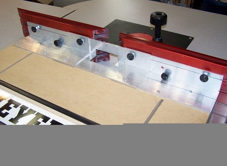

        • Knottscott
          • 3815
          • Rochester, NY.
          • 2008 Shop Fox W1677
          Here's mine. It uses the same fence faces you see in the other pic...he goes by "mbg" IIRC. The fence is the crosscut fence from a 22124 ans 22114 from Sears. Places like Hartville Tool, Rockler, and Woodcraft all sell some type of slotted fence too. I used aluminum angle as the support.
