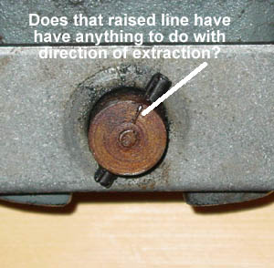

    Hi, all. I'm sure my UPS delivery person wasn't too happy, but I was the high bidder on a Columbian 7-RD wood vice. I'd even bet that it's the very same one I used in my 7th-grade shop class, what, 38 years ago. Just kidding. Anyway, I want to disassemble this 30-plus-pound relic and clean it up for its next life in my garage-based sawdust factory. The key to an orderly breakdown is a rolled pin. I'd like the members' opinions on extracting the pin. Is it directional? That is, should it be tapped out in a certain direction? Does the raised line mean anything, relative to this task? Or, should I shut up with the stupid questions, and just bang it out? Please see the attached image.

    I've taken out many roll pins. Some can be a bear, others not so bad. First, they're not directional when used as shown in your picture. Look first for any scoring or "knurling" on the pin that might hinder the punch-out. If all OK, then I suggest taking it out to whichever side is already most exposed (your picture does indicate that it is already further out in one direction than the other, so go with it). Spray the joint with Liquid Wrench or some other solvent/penetrating oil, and try to relieve side pressure from the collar by tapping it lightly. Now use pliers to try to push the pin in from the short end, using care not to wreck the pin, or score it in any way. Once one end of the pin is flush, use a pin punch of the appropriate size and a hammer to punch the pin out the rest of the way. You may need to use pliers or an OLD pair of diagonal cutters to grip and pry the pin from the end you're moving it toward. Once the pin is out, get a new one of the same size. Do not re-use the old one UNLESS it is perfectly straight and bears no scars from the removal.
      • 22106
      yeah, there's definately no directionality. Follow Just4's advice.
