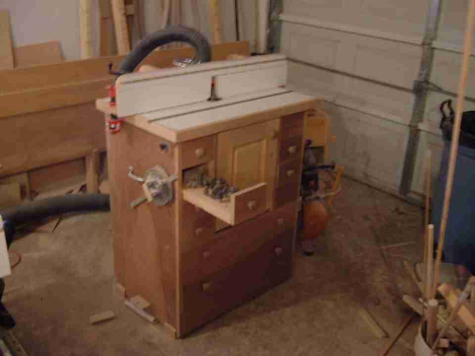

                I'm on my third router table with no plans to replace. Things I like about mine include:
                Built-in lift. I essentially copied the design from an American Woodworker article of a few years ago. The router mounts in a carrage that slides on two machined steel 3/4 inch rods attached to the back of the cabinet. A 3/8 threaded rod moves the carriage up and down. A little heavy so you don't spin the adjustment screw with your finger tips but it doesn't take much force. I think I paid something like $50 for the parts.
                Drawers on right for 1/4 inch shank bits plus drawers on left for 1/2 inch shank bits. These are on either side of the center compartment for the router.
                Dust pickup from both the fence and the router compartment.
                Top tilts up for bit changes and cleaning. Best bit changing I've seen.
                Top sits flush with the cabinet in the back so I can mount a melamine covered board to the back to form a horizontal router table.
                I have router slots for both the vertical and the horizontal mode of the table but if I was doing it over, I would eliminate the one for the vertical mode. A sled is far more useful because the router fence does not have to be parallel to the miter slot.
                Top is a sink cutout backed by 3/4 plywood edged with maple. There is no insert. There is a 3 1/2 inch hole with pieces of sink cut out scrap that fit into the 3 1/2 hole and are held with screws for rare occasions when a 3 1/2 hole is too much. This doesn't work as slick as most of the table but works.
                Fence is held in place by little pipe clamps screwed to the fence that clamp on the outer edges of the top. Simple, pretty cheap and plenty solid.
                Little drawer for small parts above bit drawers and large drawers on bottom for extra routers and accessories.
                Switch is a metal electrical box with a metal cover plate with holes for a light switch and a outlet - both 20A. Router plugs into outlet and is switched by switch. An extension cord with the female end cut off carries the power to the metal box. Simple, cheap, works.
                Wheels I would do differently. I have 4 inch casters on one end with the idea you lift the other end to move it. It is so heavy that is a chore. Instead I made a little lifting device that acts on a small piece of 2 inch angle iron which works but is a bit cumbersome. Locking casters would probably be a better idea. The 3/4 back on the cabinet plus all the other 3/4 ply in the cabinet makes it HEAVY.
                It is 1/4 inch shorter than the BT3100 and is used as an infeed table occasionally with the fence removed, of course.
