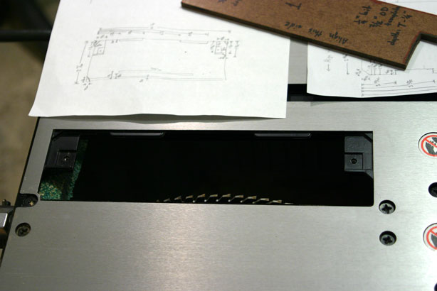

Most of you don't have a problem buying or making a zero clearance throat plate for your saw, but it seems most cheap benchtop saws aren't designed with ZCTPs in mind. Mine came with a metal TP that has over half an inch gap around the blade. The TP is supported by several shallow irregular supports and the other side of the opening has a chaffered edge.

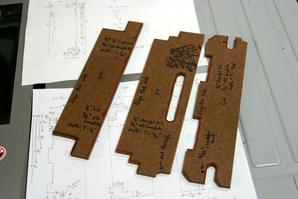

I spent a while measuring out the profile of the opening and drawing a diagram. Since there are three different depths, drew up three different templates and cut them out of 1/4" hardboard.

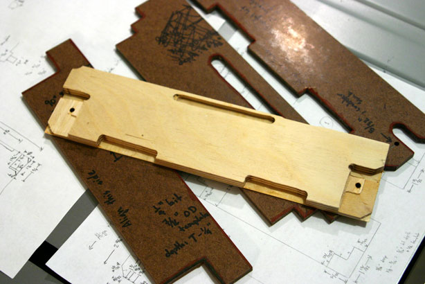

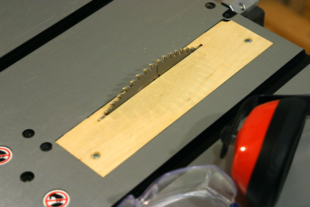

Now when i need a new ZCTP, i just cut the blank, load up the right bushing and bits, go through the sequence of templates, and drill a couple of holes for the screws. I use rubber washers to level it with the table.
