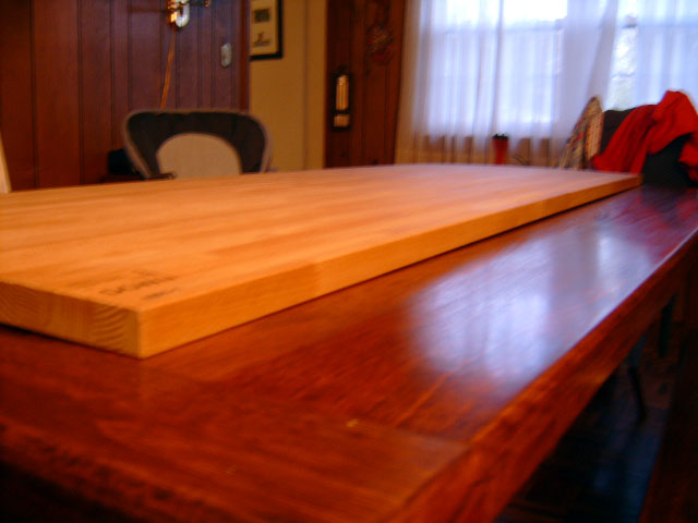

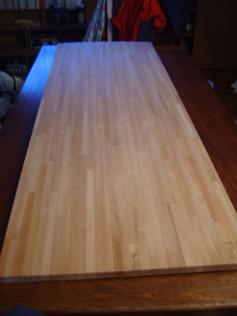

    I seen someone talking about this a while back and on our way to DC this weekend we stopped at an IKEA and I picked up a 6'X2' solid beach counter top to make a nice work bench. it appears to be warped on everyside toward the center. Basically every corner touches and there is a slight curve on everyside almost like they meant to do it that way. Which way do you think I should use it? bowl up or down????
    I am not going to try to flatten it with the truck and since its maybe meant to be that way my initial guess would be to make the center the highest point. make sense? Maybe it will flatten out once its in the garage??
    Would poly on one side help it go back? Its made of a tons of small pieces of wood so I think they meant to do it this way. every side is equally curved.

    You could rig one of those jigs that suspends a router over the whole surface, leveling it out. How much did they charge you for the top?

        Personally, I'd take it back - too warped for use as a workbench.
        There's no reason to make a curved table top except by accident and then call it curved to sell it to some one.
        Or, use it for a dining room table and take your dining room table out to the garage.

          If it were me, I'd:
          1) flip it cup up (corners up)
          2) build a frame to go underneath it
          3) use clamps to pull the edges/corners down and attach with glue and screws. Maybe using pocket screws.
          I'd build the frame using some good hard wood (ipe? ), two long pieces and four cross pieces. The frame could be used for attaching some sort of base or a vise or other attachments, if done right.
          Or just park a truck on top of it for a few days.

            I had to fit six of those beech worktops recently (two joined along the long edge for a breakfast bar) and all of them we as they were meant to be - perfectly flat. I'd return it pronto.

                Because of the way they're made (loads of small staves, glued and finger-jointed together), it'll be a real bear trying to straighten it out. If there were a few joints it might be possible, but the amount of glued surfaces means that it probably skewed when made and that's just how it'll stay. Nothing to lose by sealing just one side to see if it creeps back, but I wouldn't hold my breath! If it doesn't move, I think you'll have to live with it. Trying to plane off the raised corners (with the cup uppermost) would be a nightmare, as you'd keep running into end grain at the start of each stave.

                  Just return it to the nearest IKEA. Or throw it out. You will not make it flat easily - and constructing a special frame that would keep it flat is gonna cost you a mighty extra.

                      If you have a 6"+ jointer, cut lengthwise on the TS into 6" strips. If you have a 12"+ planer, you can cut it into 12" strips. Square the strips on the jointer/planer. If you have a biscuit joiner, create slots and add biscuits. Whether you have the biscuit joiner or not, glue and rejoin/clamp the strips back ensuring no warpage.

                        I am using one of such countertops for my makeshift workbench. You will have to make a good support frame for this countertop anyway if you want a good workbench. I have this countertop, I put a 3/4" sheet of MDF on top of it for weight and thickness and it still sags in the center when I use hand plane.
