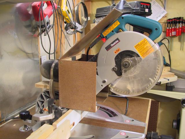

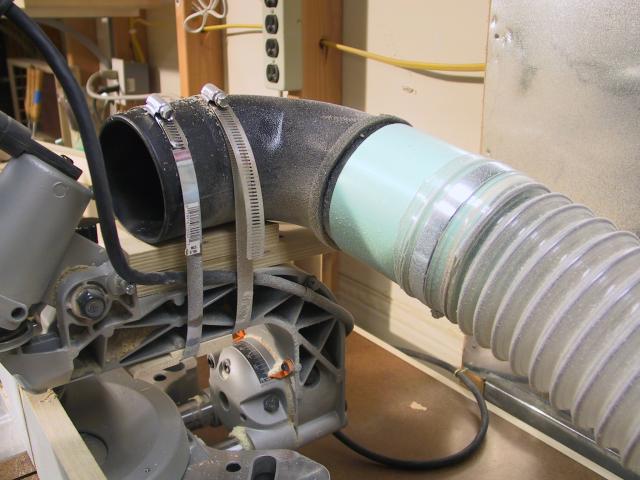

                The best (and first) thing to do, IMO, is get everything out from between your saw and a 4" pipe. These photos are of my (dual miter, dual bevel) SCMS -- an even more unwieldy task for DC than a CMS.
                After you get the 4" fitting in place, you can try to extend the flow zone around the saw. That's where things get a little kludgy, at least for me:
                Since these pictures, I've tidied up the connections, etc. More importantly, I've made the enclosure so it's very quick to put on and pull off. If I'm beveling at 45 degrees, the current enclosure can't stay. The 4" hose can, though, and that's what catches 80% or more.
