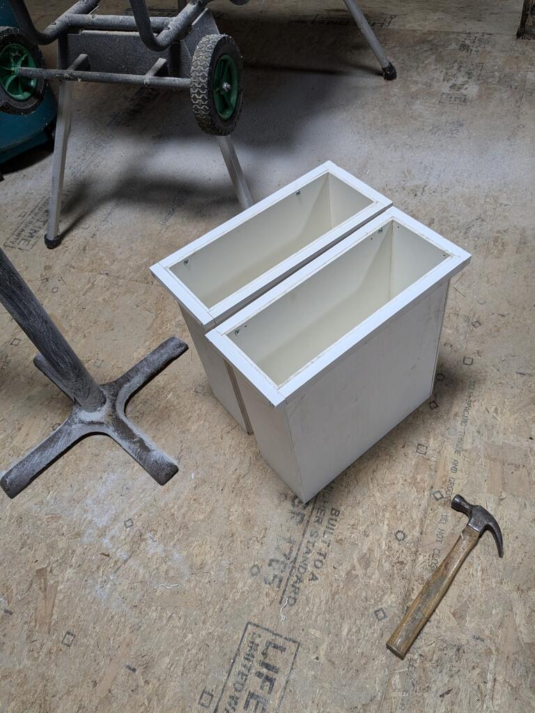

        So just to circle back, I came to the conclusion I have to make the bins 16x6 or so on the outside, which gives a 44" circumference. That's kind of a long, narrow bin, and I couldn't find anything remotely close in size, so I decided to make them. I want them to be washable, so I got a sheet of quarter-inch Azek. There is an Azek glue and the claim is that the joints are stronger than the material, so I decided to glue them up.
        The challenge was how to hold them together while the glue sets, the label recommends allowing 24 to 48 hours for setting. What I did was cut pieces of 3/4" particle board equal to the inside dimension and then screw the pieces to the particle board with lath screws while the glue dries. I cut the particle board pieces first, and it was handy having them while cutting all the other pieces as a quick reference for setting the rip fence.
        Here's a pic:
        Once the glue sets I'll remove the screws and the blocks. It doesn't bother me having screw holes in the bins. Next step will be to glue a piece of 3/4x3/4 Azek around the top to make a rim to hold the garbage bag and hold the bin in the drawer. Then I'll build the cabinet to fit the space -- and fit the bins!
        I'm a little worried that the Azek glue will stick to the wood but I'll deal with that when it happens.
        Despite the somewhat awkward shape, I calculate that it's 1534 cubic inches, which is 6.6 gallons, somewhat respectable.

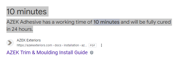

            It's PVC. The glue is like the glue for PVC pipe, it dissolves the plastic and melts it together. I don't know why it takes so long to set up.
              Click image for larger version  Name:	image.png Views:	0 Size:	25.8 KB ID:	859403
              It probably sets pretty fast if the working time is only 10 minutes, not much longer than PVC pipe solvent glues.
              However, full strength is not achieved for 24 hours. Same as they say for PVC pipe glues.
              I watched the sprinkler repair guys blow apart my repair waiting about 5 minutes when they pressured it up too soon, They wanted to bury it and go home.

                Tonight's project was gluing on a rim, the screws are just to hold it while the glue sets:
                The wood blocks had stuck to the glue. The hammer is there because I used it to knock the blocks off. The joints held which is encouraging.
                  so how does the bags fit?
                  • Nick Keenan
                    • Apr 2004
                    • 457
                    • washington, dc, USA.
                    Like a glove!
                    I need to round the edges a bit so they don't poke through the plastic, but otherwise I'm pleased. It is kind of a funny shape but the space I have is what it is.
