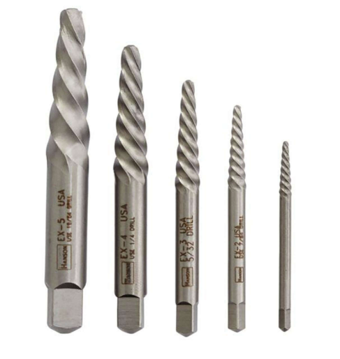

    Another suggestion that occurs to me is to secure this to a drill press and use a screw extractor kit which involves drilling a appropriate sized hole in the remnants of the upper and lower barrels, and then using the extractor to enter the hole and dig into the piece and literally screw it out.

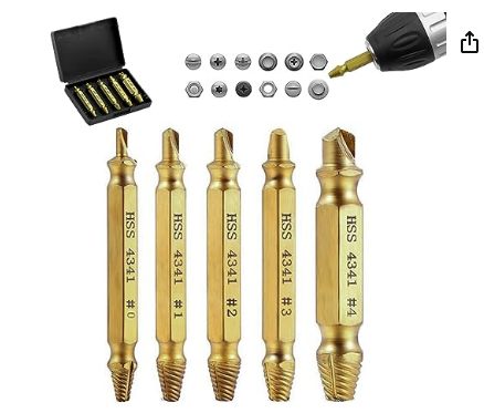

    extractor bit set sold at hardware stores every where for removing broken off, screwed in screw shanks. Use a tap handle turning counterclockwise to wedge the extractor into the screw and rotate it out. I realize the barrels are not screwed in but the rotating action will loosen them and the threads on the extractor will grab the inside of the hole you drilled. Brass is soft to drill but you may need to dremel a flat to enter the drill. THe drill size should be small enough not to damage the existing wood hole and large enough to enter the tip of the selected extractor bit. It might be good to start with a small bit like 1/8" and enlarge. Simply drilling might cause the barrel remnant to rotate and start to come out but will be pushing it the wrong direction.
    Click image for larger version  Name:	image.png Views:	0 Size:	132.7 KB ID:	855804
    Set with drill tips
    Click image for larger version  Name:	image.png Views:	0 Size:	133.3 KB ID:	855805​
