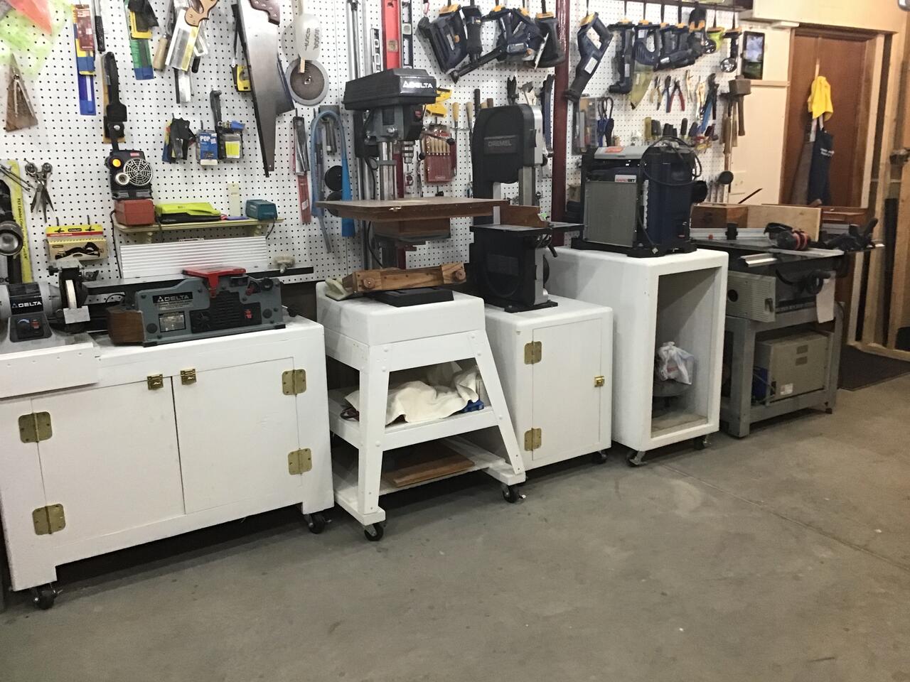

    I'm curious. What was the price for the plastic cabinet? I made my rolling tool cabinets from 2x scrap lumber with 4" casters from HD with doors of scrap plywood and scavenged hinges. The exception is the drill press stand that utilized the stand from the BT3100 with a 2by riser and 2by bottom rails to screw the casters to.

    Jim Frye
