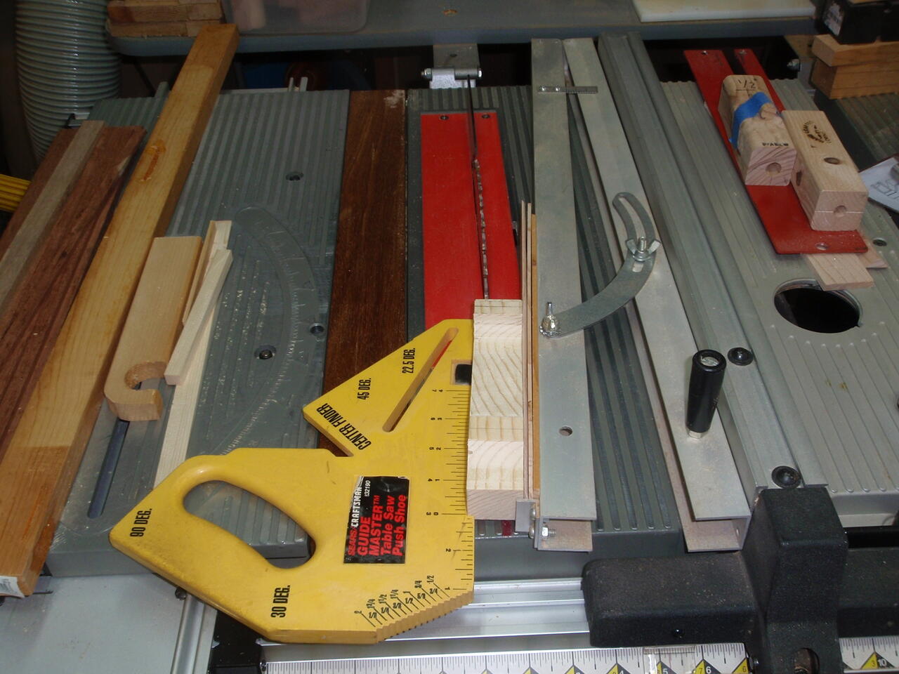

        • 22053
        this piece was thick enough to use push shoes on the side.

        The next rip was thinner (no picture) and was where I glued it all together.
