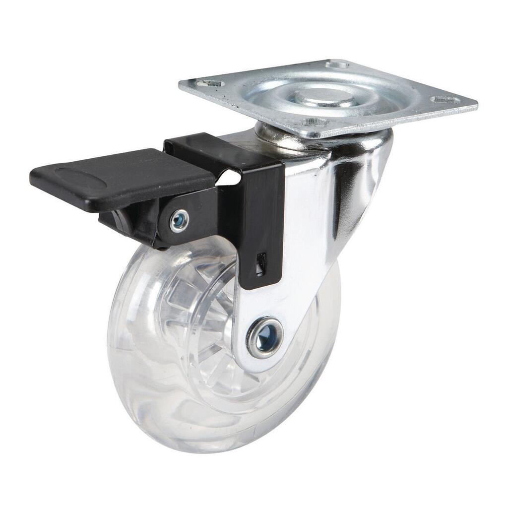

      So digging through my parts in the tool chest. Yeah that crap needs to be gone through and put to use, recycled, or done away with but I digress...
      I found I have 4 of the 3" urethane light duty swivel casters with brakes.
      https://www.harborfreight.com/materi...ake-69538.html
      I need 4 fixed 3" casters without locks, however the wheels do not seem to match for the fixed casters. I'd rather not have swivel casters, so assuming height to the mount plate is the same I am thinking of getting 4 of these...
      https://www.harborfreight.com/materi...ter-96407.html
