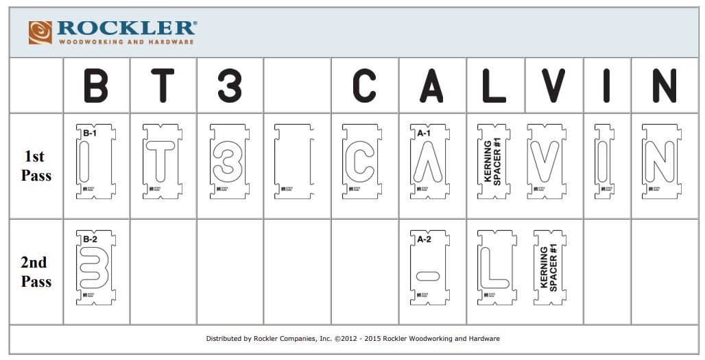

    Got this State Parks sign lettering kit from Rockler, it works pretty well and is easy to use. Uses two passes so you don't have the stencil-like split lettering. Also has Kerning so that wide bottom letters next to skinny bottom letters (like AV or LV) tuck under each other and look properly spaced which used to have to be a manual task to measure properly. Example the LV in CALVIN above.
    Comes in 1.5", 2.25" and 3-3/8" high letters. Each size requires a different set/kit.
    This is the 1.5" on 1x4 lumber.

          IF you use signmaking.rockler.com
          if gives you a detailed instruction on what the kerning and two-passes will look like. After some practice you don't need to use it anymore. I wish it would tell you the exact length of the finished sign but it doesn't. Example showing two passes with Kerning spacers.
          It has two endplate templates that I fasten down with masking tape and then you can sub the 2nd pass templates accurate in place without moving the whole thing.

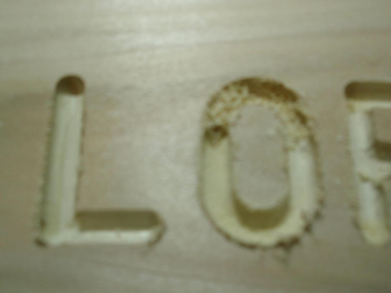

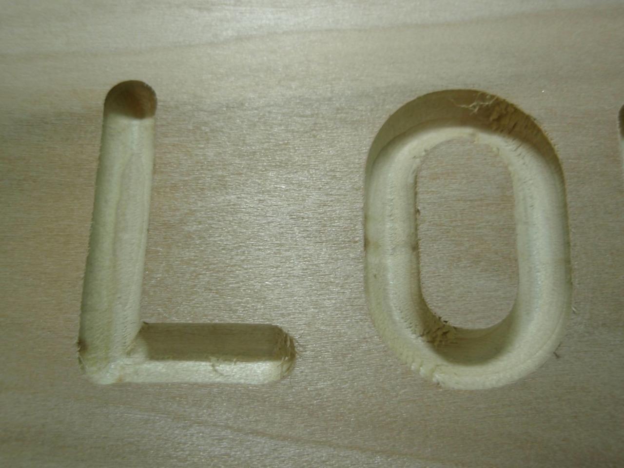

                            Hank, I have the 1.5" set. THey recommended the 3/16 round nose bit which I got for $20. But the bushing has an ID of 5/16 so I got a cheap 1/4" round nose from Amazon for $7.95 and I really like the fatter strokes a lot. Makes a big difference.
                            For the 2.25" set they have a bushing ID of 1/2" and the recommended bit is 3/8" dia. round nose. A 7/16" might fit but I couldn't find any. The Rockler 3/8" is expensive, I think it was $29. Amazon or MLCS will get you a much cheaper bit. I think Amazon has Freud 3/16 radius for 18.86 and Yonico 3/16 radius for $8.95. MLCS is $12.
                            Also be careful a lot of round nose are sold by radius not dia. so a 3/16" radius is a 3/8 in dia.
                            The 1/4" Dia Yonico I bought left a bit of a fuzzy edge on a poplar board, I have to sand the face 150 grit to clean up the edge. Not sure if MLCS or Freud is better about that. Before sanding: (sorry about focus) but you can see the fuzz

                            after sanding
                            Click image for larger version  Name:	PA290009sm.JPG Views:	0 Size:	117.3 KB ID:	841188
