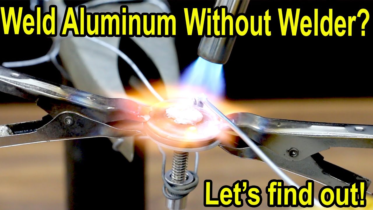

        On the framing. I have been teetering between aluminum and steel. Steel for strength, aluminum for corrosion resistance and weight. The big issue has been how to weld aluminum and make it a strong weld...
        Then I came across this video / test of various aluminum welding / brazing rods. Harbor Freight's alumiweld actually compares very well with over 1100lbs pull before failing and in torsional tests proved stronger than the aluminum itself. I think we have a winner.

          Alumiweld - in general, I recommend people get experience before starting something new like that, but I can tell you are one who can figure it out as you go and do extremely well. I had a talk with a bunch of preachers today on close to the same thing: "All can read, but only a few can figure out how to DO it."
            • 9447
            Practice makes perfect. And I have access to clamps, and plenty of scraps to practice on before I dedicate to any serious costly construction....

                Just a quick update. I have been doing some test brazing, not really welding I guess, with Harbor Freight Alumaweld, a Bernz O Matic torch, and Propane, it's working, although I see pretty much everywhere that on larger pieces MAP gas is preferred, I will try that next...
