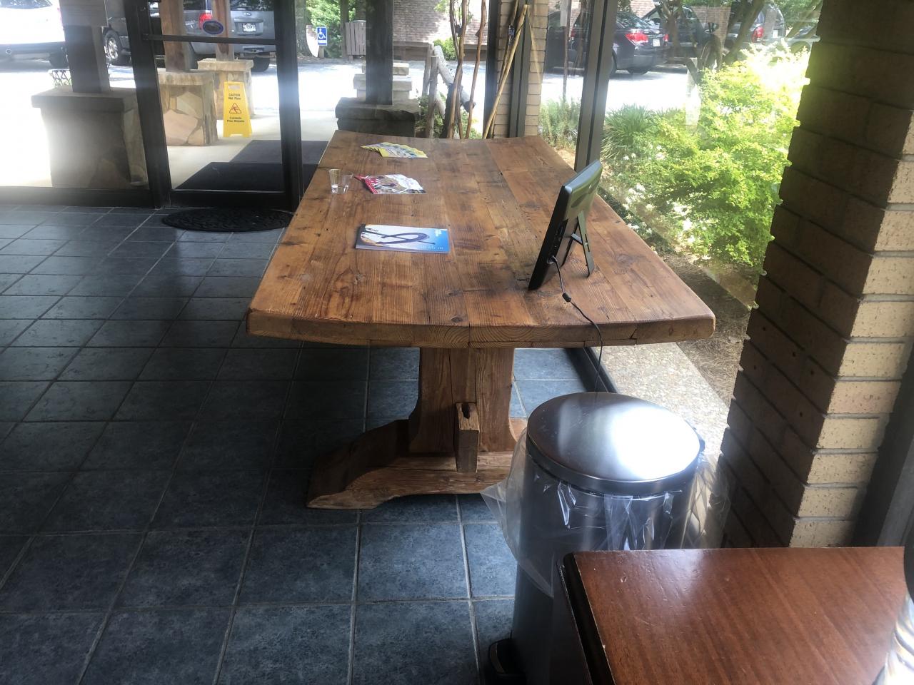

              One thing you want to do when using narrow slabs is to choose your pieces wisely. Pieces that have the grain running across the width of the board will warp or curl. The flooring boards will probably be tongue and groove, be sure that the tongue and the groove are both cut with plenty of 90 degree to the top surface wood to glue up. For flooring purposes it isn’t necessary to have this glue up surface as the boards will be nailed to the subfloor. The tongue and the groove sides may have to be cut off.
              You don’t want your table top to warp up like this large pine table did. Not mine. The sides must be over 1” higher than the middle of the table. Note the failed attempt to correct the warp on the bottom of the table slab. They didn’t have a clue.
