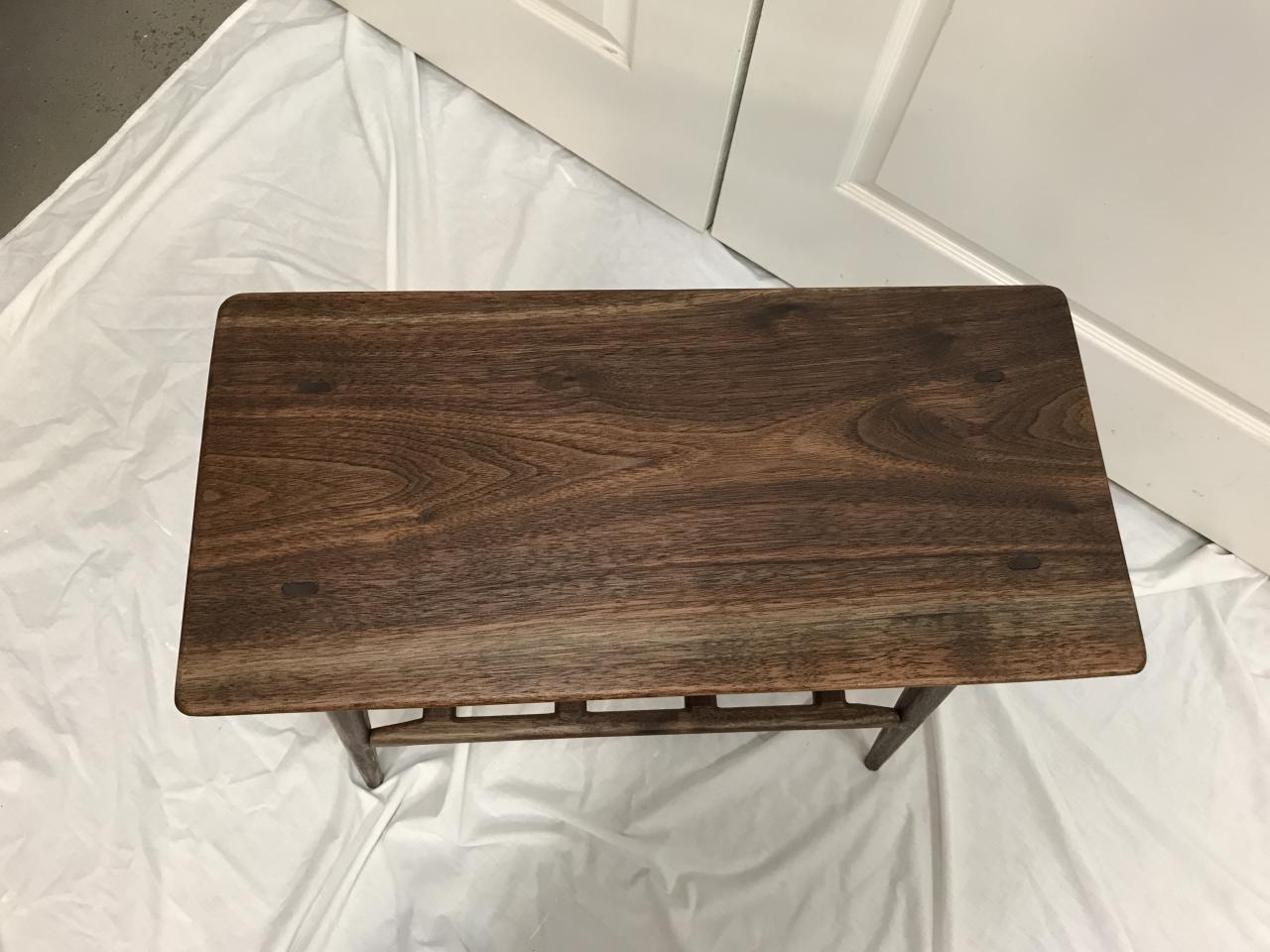

ID:	832523I think that the front panel of your humidor, the dirty looking spots, will blotch. Like Atcgpaul suggested using shellac will help alleviate some of the splotching. I’ve used Bullseye clear shellac thinned 1 part shellac with 3 parts alcohol on some of my Tiny Tables. Wipe it on with a soft rag and immediately wipe it off with a dry rag. To me Minwax Red Oak stain seems to bring out the grain and character of the wood. Everyone seems to like the tables better cherry stain on cherry wood. One thing that I have found with my dealing with cherry is that the finer I’ve sanded it the less problems I have with splotches. I generally sand the table tops to 1000 grit and apply red oak stain without the shellac wash,
        photo of cherry stained wth red oak
