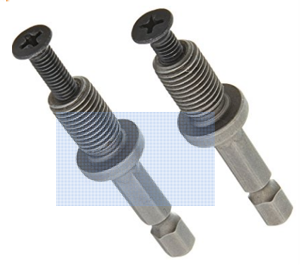

    I assume the drill shaft end looks like this, the big thread being the 3/8"-24 UNF.
Name:	drill chuck stud.png
    How do I secure the motor shaft so I can unscrew the chuck?
