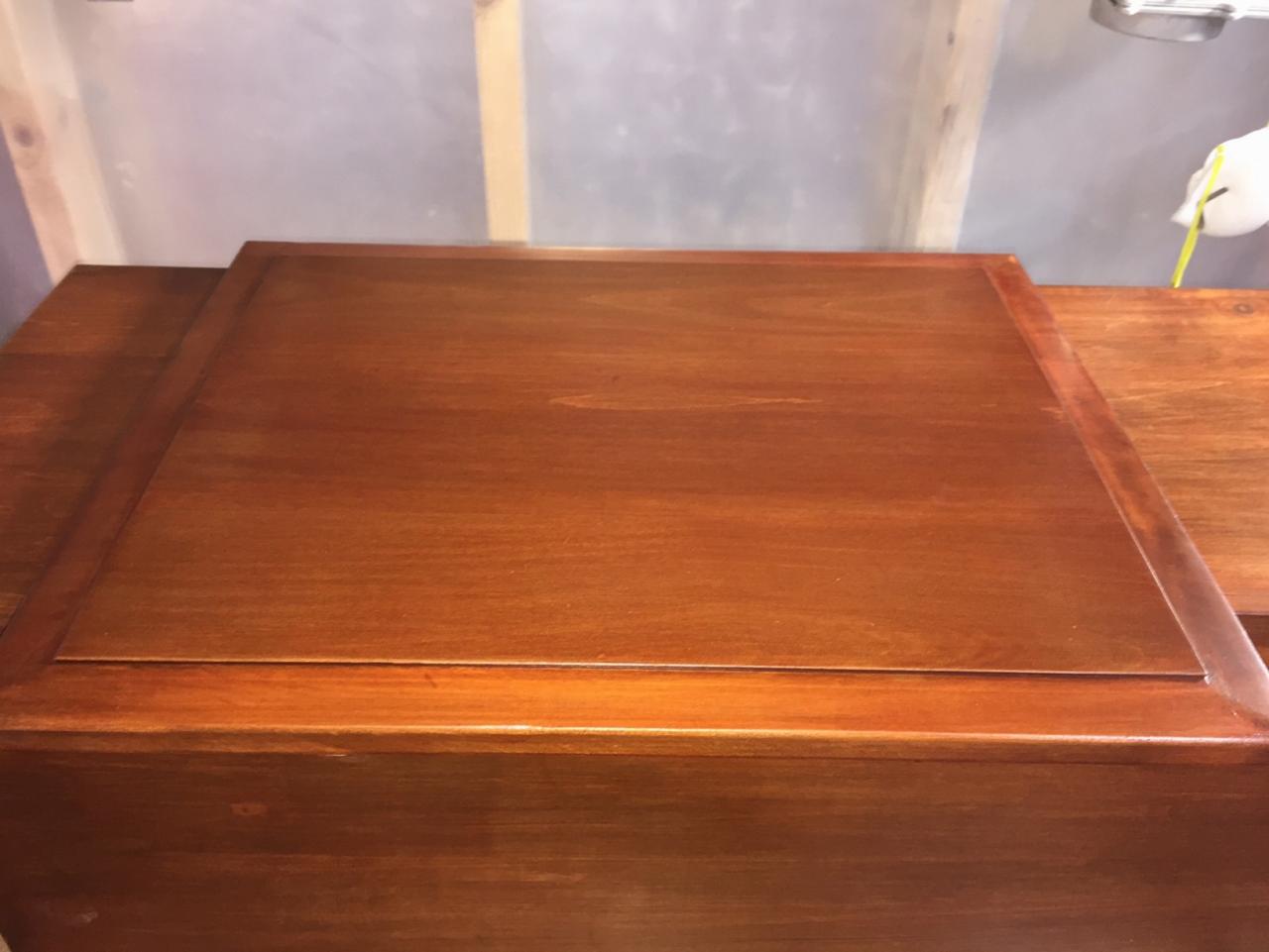

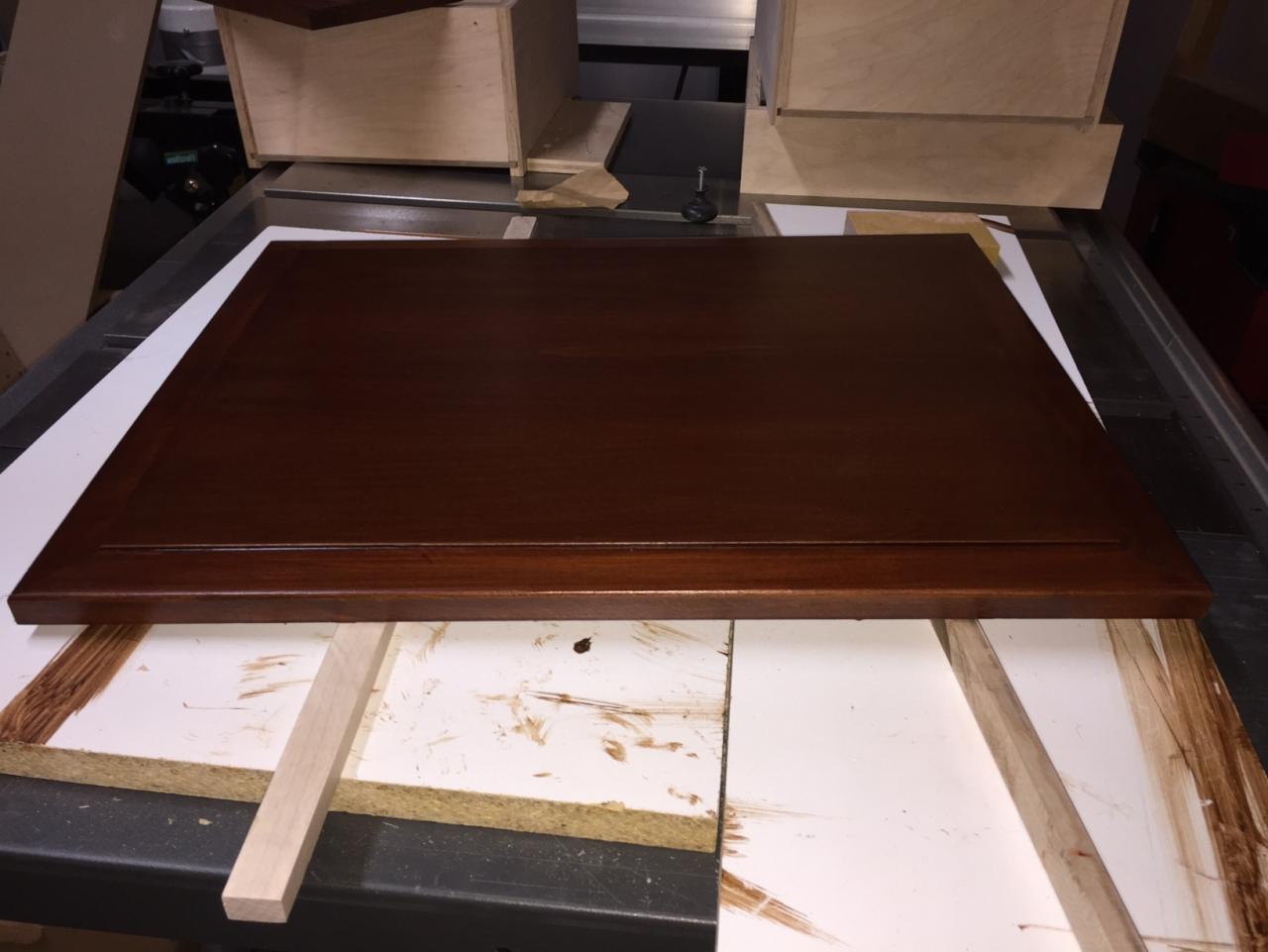

    When is enough enough?
    So I'm working on a jewelry armior for a gift and I'm down to the finish (and I now understand how little I know about surface prep--LOL). I'm using a water based poly in satin by General Finishes. So far I have 4 coats. My question is how many coats do you usually put on. For what it's worth, here's a couple pictures. The pictures aren't that great due to a florescent light on one and kind of dark on the other one Click image for larger version

ID:	829875 , but you can get an idea. This was my first real attempt at a glue-up top and "raised panel" edges. This started as 1x6 maple. It actually looks better in person.
    What does General Finishes suggest for the application method you chose?
    I like GF products. I usually spray it because it sprays very nicely. For a kitchen countertop, I applied 3 coats of their high performance poly. The area around the sink was the area of most concern to me. It has held up very well with over a year of use and I don't see any signs of degradation from water.
    I think you're good with 4 coats for a jewelry armoire that will see much less abuse than a kitchen counter.
