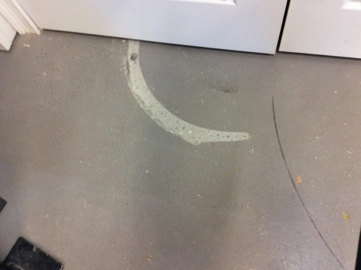

            This is what a concrete floor with epoxy paint looks like when you put too much weight on a hard plastic caster. It cuts down into the concrete! Click image for larger version

              You could use 4 conveyor roller bearings and pvc pipe to create 2 rollers the width of your bins and it wouldnt dig up the floor and would track straight.
