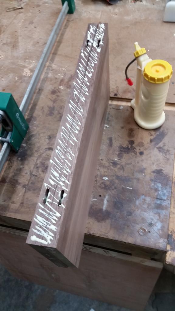

                    Yep, that's just the right amount of glue. I have a mixture of these parallel bar clamps and the el-cheapo aluminum clamps from HF. Now with flat boards, the HF clamps do a fine job, too.

                    I have been in Camp Norm when it comes to glue squeeze out. That is, glue it up and wipe off the excess with a wet rag. Pretty messy and I didn't really have a problem with getting glue smeared in the grain. I'm going to go try scraping it off in about an hour. I decided to keep some boards turned 90deg to the others to see if it matters for glue cleanup.
