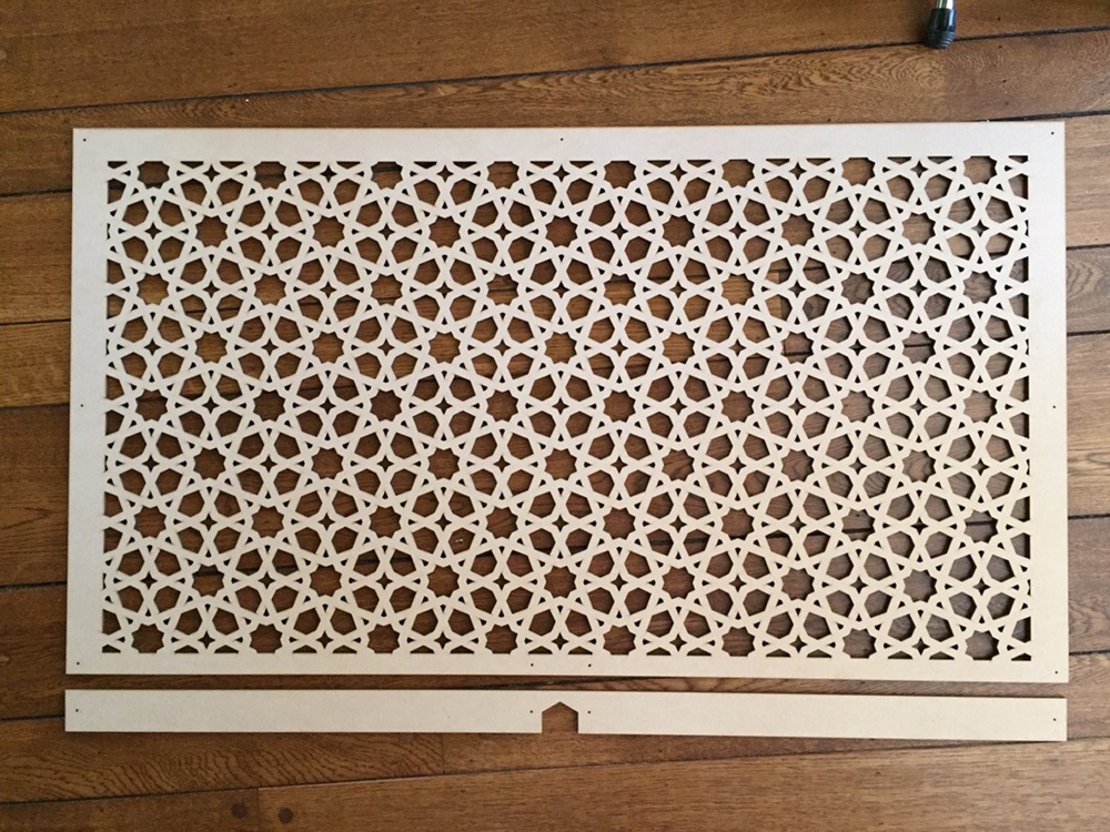

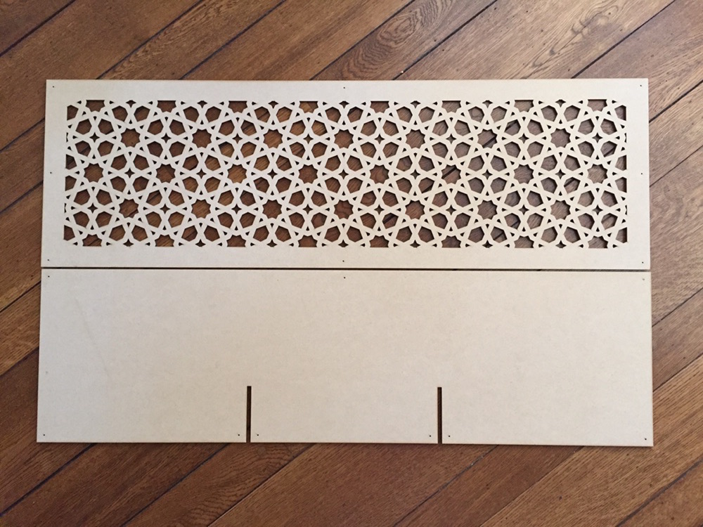

                      Here are a couple of photos of the panels, pre-paint. The cabinet will be a stereo/record cabinet:
                      I think the screw with oversized holes ideas may work best. With magnets, velcro, tape, caulk, etc. I worry that the boards will warp over time.
