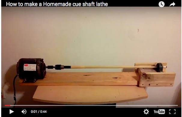

    Howdy folks. I have an idea bouncing around in my head (dangerous), and I don't have the knowledge to implement it. So I'd appreciate any input.
    I play pool quite a bit, a pool table has taken over my shop, in fact I have to roll my BT3 out of the way each time I go to shoot. There are a couple maintenance tasks that are necessary and basic, but I am finding them hard to properly do by hand. It is important for a pool cue shaft to remain very smooth to play the game at a higher level. Also tips need to be replaced from time to time.
    Both these tasks are made much simpler by the use of a cue lathe. These lathes run $500-$700 for a maintenance lathe (what I'm trying to cheap), to thousands for a lathe to build a full cue.
    I want a simple lathe to simply spin the shaft to facilitate cleaning and sealing as well as making tip replacement far easier. There are cue repairmen that can be found, however it can run $25 for a tip, and double that for a cleaning and tip and higher. Plus the time it takes to finish the cue during which I am unable to play.

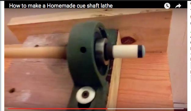

    WHEW! Sorry for the lead in. Here are a few examples of motors and 'stabilizers' (the bering thing) of what I would like to do. I need ideas on how to attach the drill chuck to the pulley, or like the one with the direct motor. Also what type of bering is that that these guys are using? Thanks for any input.

    Cool project! And I forgive you in advance for splitting your affection for the BT with a pool table. A man's gotta do what man's gotta do!
    The bearing is called a "pillow bearing". And I think you're looking for a "shaft collar".

          Thanks, "pillow bearing" helped me find what they were using. Generally pretty cheap too.

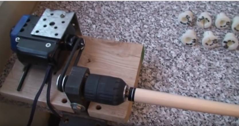

              In my last picture there, with the small motor, belt and drill chuck, can anyone tell me how that is put together?
              I assume its another pillow bearing with a shaft of some sort and a pulley, with the chuck attached to the shaft.
              This is the first challenge I have to overcome…
              How is that assembled:
              What size shaft? What size pillow bearing bore? How does the shaft attach to the pillow bearing? How does the chuck attach to the shaft?

                It looks like the cue holder for the tip end is a tapered bushing made with the que's angle (taper) inside and outside diameter to match the pillow block bearing. To get that part you will probably have to obtain your donor lathe first and custom make it to fit the pillow block you buy. If you just stick the cue through the bearing and tighten it up you will have a ring pressed in the cue.

                  There is a plastic "shaft collet" that you see on the table in the last photo. They are designed to fit different shaft diameters, and prevent damage from a lathe. My shaft is 12.75mm, and does not taper for the first 12-15 inches.
                  I would assume that a 1/2" pillow bearing would be the right choice, but the shaft and collet diameter might require a larger bore on the bearing. Another mystery.

                    Ok, I'll try a specific question. How do you attach a drill chuck to a shaft? I've seen different size chucks for sale, just don't have an idea how they affix to the motor or drive shaft?
                    Some kind of set screw? That seems unlikely but all I can think of.

                        Raffi, most drill chucks attach using a screw through the bottom/back of the chuck, access when the chuck jaws are fully opened. To attach to a shaft, you would need to drill a perfectly centered hole in the shaft (which would possibly be done on a metal lathe, or have a machine shop do it), and tap for the appropriate screw.
