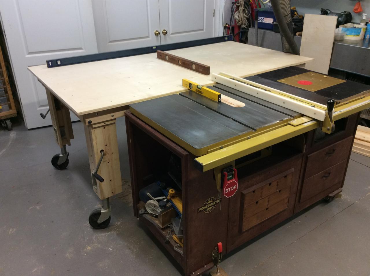

    I'm in process of building an outfeed table for my moble base mounted Powermatic 64. The requirements are that it must be usable for the planer and drum sander and easily storable. Legs have trailer toung jacks that allow 10"+ of elevation change. Finish is to be determined later.

        great idea, do you have to remove the TS fence to have it sit over the top?
          • 3791
          The rip fence does not have to be removed but that requires jacking up the legs another 4 inches so I will probably take the fence off. The moble base has a void beside the saw cabinet that houses the rip fence fine. It takes about 5 minutes to jack all 4 legs up from saw height to on top of the table height. Adjusting the height and level of this table is easy.

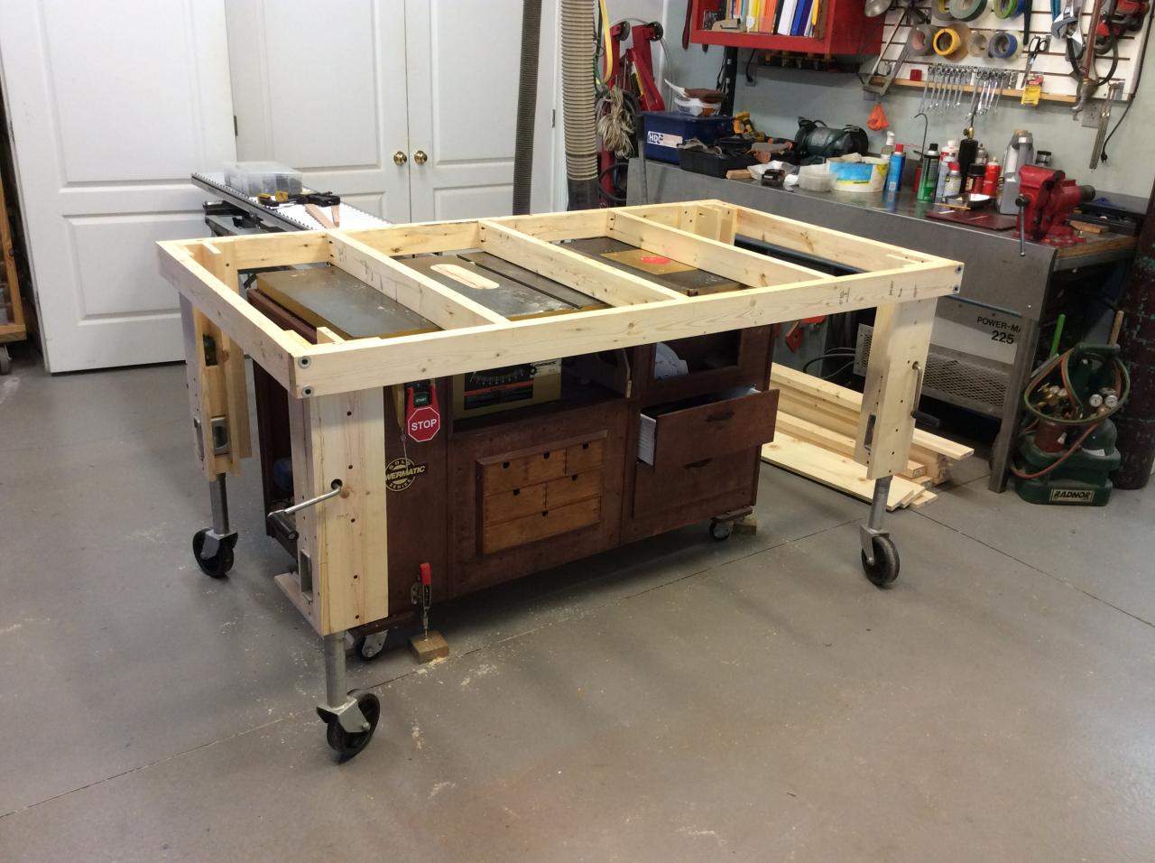

                  This project was started in Jan this year and I have not needed to move the tablesaw or the outfeed table. I need my auto shop space back so it is time to roll the outfeed table on top of the saw and roll them into the wood shop as designed. I've been second guessing whether it will really fit in the shop, whether it will be able to make the turn though the double doors, will I be able to rotate it 45 degrees after its in the shop. Hurray, it fit, actually fit better than I hoped for. After all the other portable equipment is rolled in I have my auto shop back. When I sold the Sears bt clone and got the powermatic table saw my wood shop became too small and required the use of the auto shop for the table saw and outfeed table.
                  photo of table jacked up to roll on top of table saw. Click image for larger version

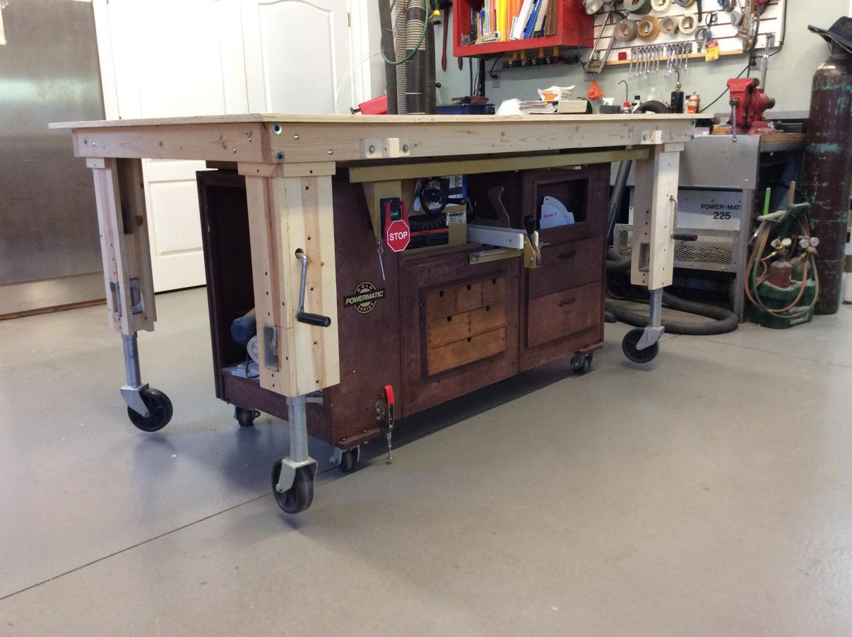

                    Photo of outfeed table rolled on top of table saw and lowered, ready to move

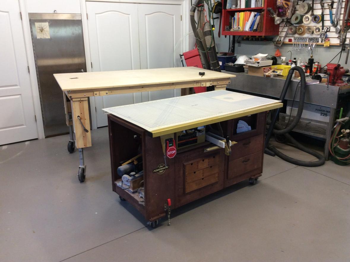

                      Photo of table saw and outfeed table parked in the wood shop

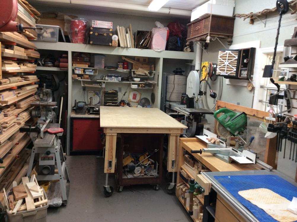

                        Photo of wood shop with the remaining equipment rolled in. No more woodworking until I get the auto repairs completed!
