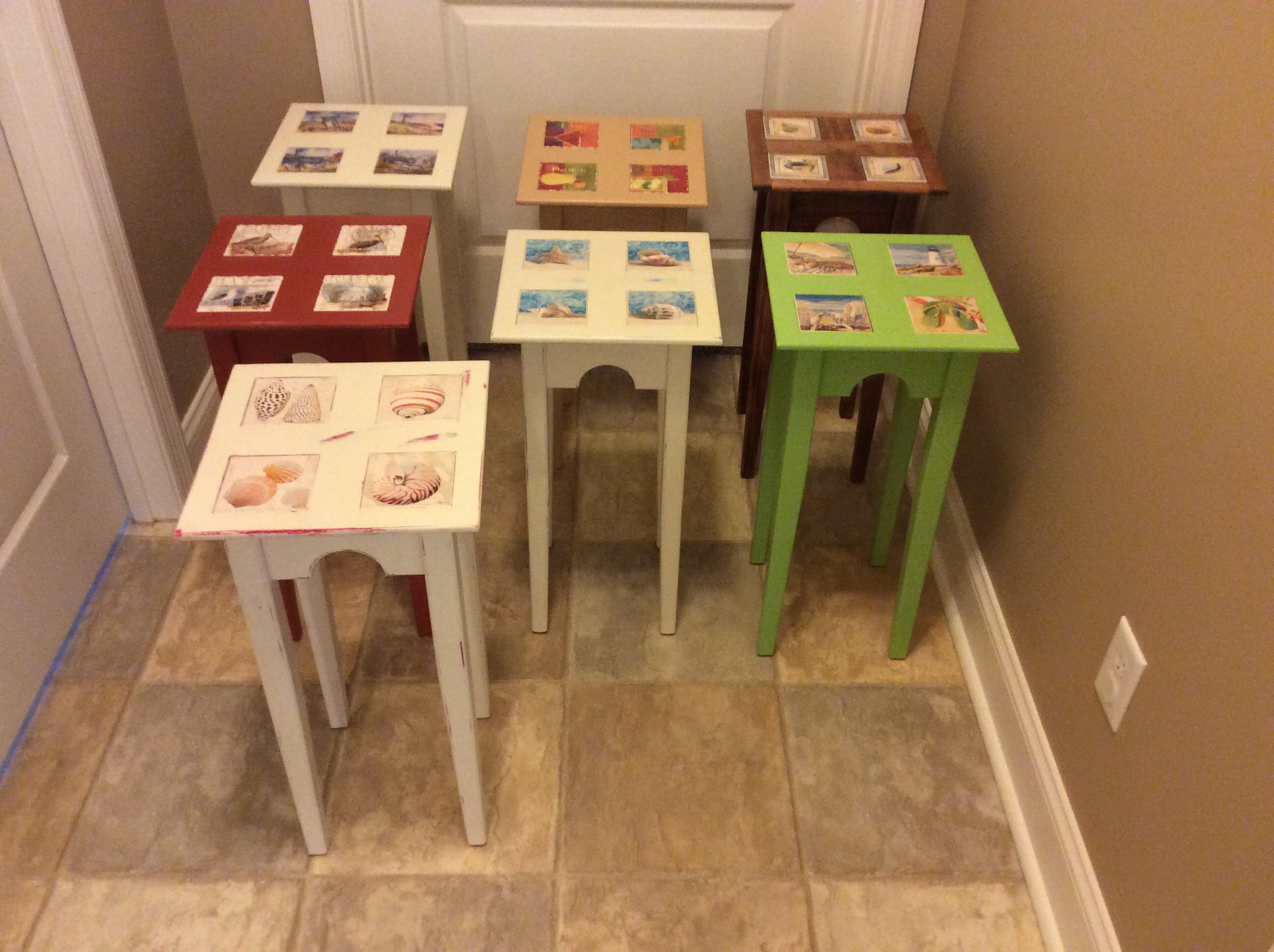

    Fast forward a couple of years attached is a photo of my first run of Tiny Tables using chalk paint that I made myself. In a couple of days I'll post some of my results from my chalk paint experiments, gotta find my notes.

        One thing that impressed me about Commecially produced chalk paint was its coverage. One quart of the $35 chalk paint might cover a bunk bed. After the desired finished is achieved I think that I would use thinned wiping poly instead of the recommended wax for a final finish.
        In all of my testing I substituted Flotrol for water. I really believe that most, if not all, of these chalk paint want-to-be's is created by people that do not have a clue what latex paint is and what the additives they use is doing.
        My experiment with plaster of Paris chalk paint was my least popular. Contrary to the reviews I read it was awful. Getting the mixture thinned enough to apply with a brush was daunting. After a few minutes applying the pop chalk paint the brush would load up with concrete making further painting mess up and the brush has to be washed out. I didn't find the pop chalk paint application to be anywhere as smooth as the in-modified water panini would have been. The whole purpose of chalk paint is to apply a finish that can be easily sanded to reveal old finishes under it to give a used or antique look. This is not easily happening with this concrete reinforced rubber paint. I've sanded marine epoxy that was filled with marble dust that sanded easier that this mess.
        The other additives being used for home made chalk paint is calcium (agricultural lime) and unsanded grout. I'll dig out my notes and elaborate on them later.

            Milk paint is supposedly different from chalk paint. The other additives that the chalk paint want-to-be that I tried was calcium carbonate which is agricultural lime. The results were not much better than the plaster of Paris concrete paint recipes. I bet the ph was all over the chart with this recipe. The other recipe was unsanded grout, which didn't work as well either and in reality it is probably plaster of Paris.
            My next experiment with making my own chalk paint will be to use a product that I have not noticed in the chalk paint want-to-be sites. It will be to use Zinnser Primecoat2 prime and sealer which is water base but I'm not sure is latex base and mix with Sheetrock mud.
            My synopsis of this attempt at making my own chalk paint using others recipes? Another example of using something, in this case latex paint which is rubber paint for something that it was not intended to be used for. Trying to imitate chalk paint which Anne Sloan manufacturers by adding plaster of Paris, lime or grout to latex paint only results in latex paint that is cut with some powder. In is terrible to sand and probably does not meet the claim that it can be painted over surfaces without being sanded and primed. But if it makes the creators happy then so be it and enjoy your creation!

                The plaster of Paris/latex paint mixture tended to load up the brush quickly and resulted in a lot of brush marks. The more you rubbed it the worse it got and required sanding. The sanding is what I call terrible because the paint is still latex and wants to ball up on the sandpaper, while the plaster of Paris made it tough to get anywhere with the sanding. It doesn't add grit. On a large surface a ros always beats hand sanding. I believe that there is something chemically going on with these mixtures, not just adding bulk like adding glass powder to fiberglass or wood fibers to white glue.
                I wouldn't want to discourage anyone from experimenting with their own mixtures. These replys are just my unbiased opinions of an experiment that I really wanted to work! Not bashing others that create these mixtures and love them. I am inclined to believe that the Zinnser Primecoat2 or another similar primer that is not latex base with calcium added it and will work as well as the expensive name brands of chalk paints. Previouse use of Primecoat proved that it sanded great like real chalk paint. I just didn't have any on hand to experiment with.
                One of the quirks with real chalk paint that is all over the Internet is the waxing process. Maybe the people writing all of this do not like the work involved with waxing? A lot of replys state that the waxing changes the colors. Waxing appears to be necessary as it seems to harden the finish and certainly seals it from dirt, coffee and other contaminates. My next chalk paint job will not have wax but will be sealed with wiping poly or my new favorite sealer shelac.
                Of course, depending on how much time and material I have invested in the job I will still buy Annie Sloans chalk paint.
