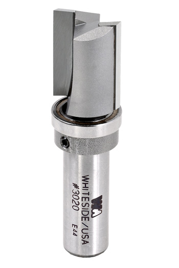

                        A router bit like this?

                        • BadeMillsap
                          • 868
                          • Bulverde, Texas, USA.
                          • Grizzly G1023SL
                          Yes... A good source is http://www.mlcswoodworking.com/shops...highlight=Dado
