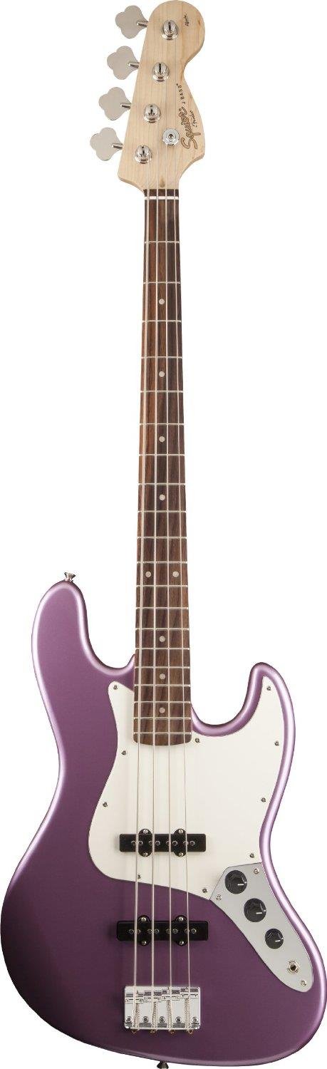

    That one is on layaway for me right now... Not sure I want that color that prominent in the room though...
    It's a cheapie, a Squier by Fender Affinity Series Jazz bass. I am probably the odd man here, but I REALLY like the neck on this particular Affinity, as it has a satin finish where the gloss on the Vintage Modified, and the Fender MIM and MIA models just feels, sticky to me...
    Of my current instruments, my favorite is the Ibanez SR480, oiled Mahogany, great smooth sound, not so much on the punchy grown that Jazzes are known for though...
