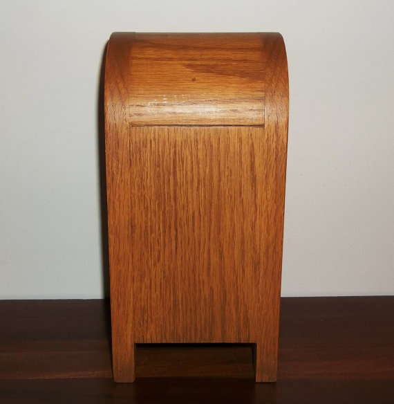

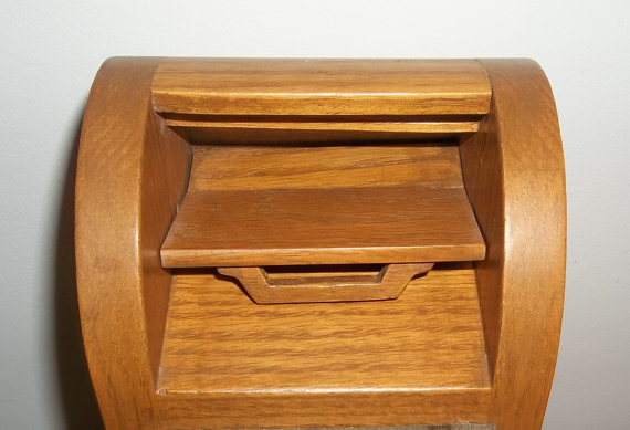

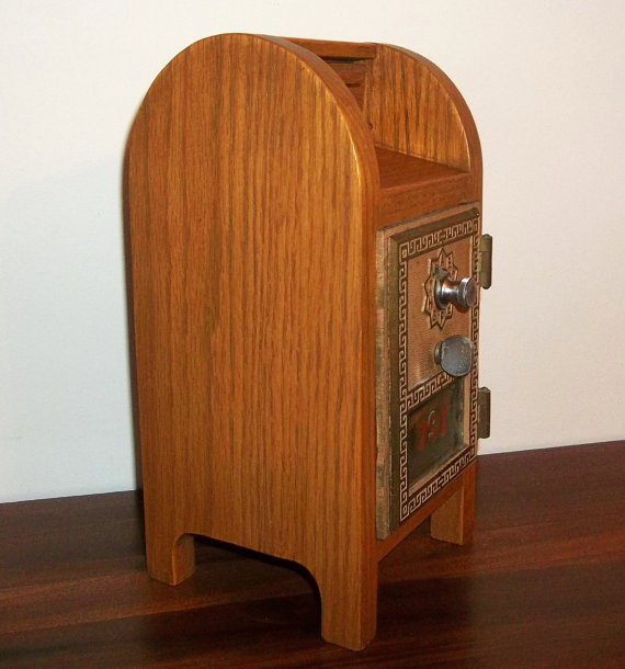

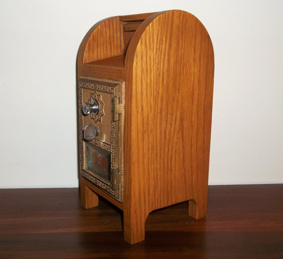

                          another one from google..no slot hardware needed for this design..
                          <img src="https://www.etsy.com/listing/129553628/us-post-office-box-door-mailbox-shaped" border="0" alt="">
                          • tfischer
                            • Jul 2003
                            • 2349
                            That is awesome. Any thoughts on how they did the mail slot? That is really cool.
