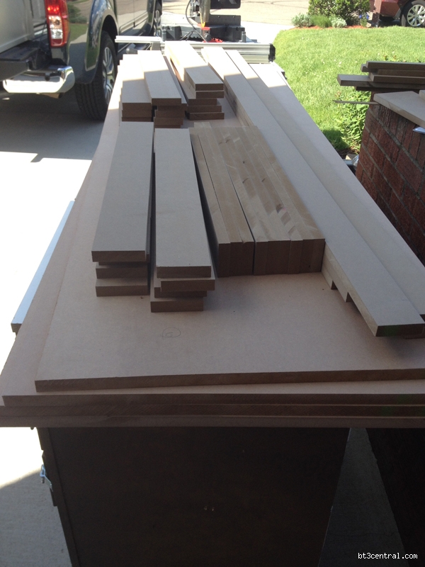

    This weekend I began the buildout of my ultimate tool stand. There were many good ideas included in this thread, some of which will be incorporated.
    This all started with acquiring 4 sheets of MDF. I was not impressed with the selection of the plywood at Home Depot or Lowes, at least at the price point i was willing to pay, so I decided to stick with the MDF. I had the stores rip the pieces in half so I could handle them by myself. At nearly 100 pounds, I was not too keen on being a hero. Besides, the widest piece I needed was 24". Might as well let then do it.
    I got to try out my new grizzly track saw....
    I also acquired one of those foam insulation boards to use as a cutting backer board. That worked quite well.
    When all was said and done, on Saturday I had done 90% of the cutting to get to the components on the cut list.
    Since Sunday was filled with other projects and my daughter's graduation. Monday was the next "sawdust" day. And I set out to build the torsion box.
    My apologies for not having pictures of the internal grid....I simply was "on a roll" and didn't stop to take pictures of the guts of the torsion box.

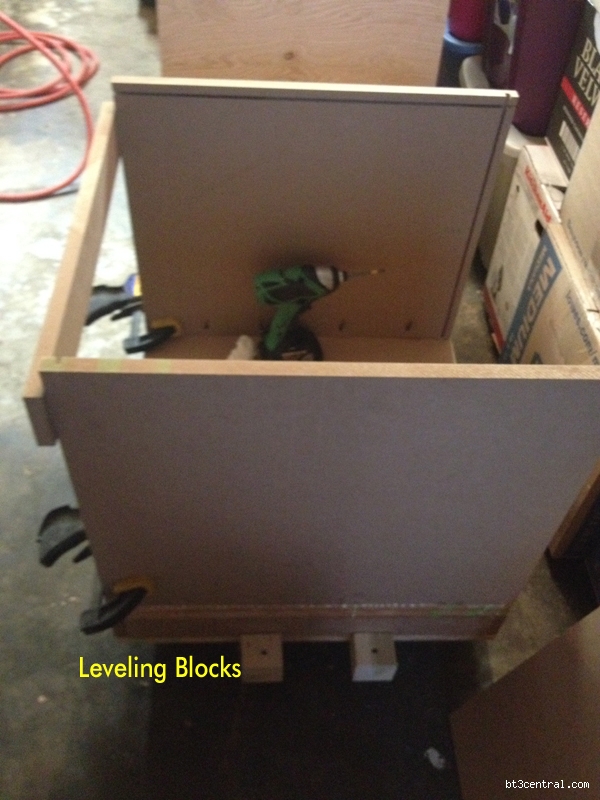

            SO last night I was able to do a few things, but was confined to the (over croweded) garage due to the toad choker rain storm we so badly needed. As a result, I wasn't able to get my table saw out to do some much needed cuts. However, I was able to get the sides of the cabinet installed. (garage over crowding is due largely in part to my step-daughter's stuff stacked in boxes before she moves to Dallas in about a month).
            While the spacing of the two inner portions is somewhat arbitrary, I made the center "space" 24" wide. I have opted to leave the back of the center portion open while closing off the other two with 1/4" ply.
            The bottoms were attached with wood glue and pocket screws.
            One of the things I opted to do which are not part of the original plans was to cut dado's in both the back, and top of these pannels. The one in the back is for a 1/4" piece of plywood. The one in the top is for a cleat, which will allow me to fasten the top piece. I will have one cleat in the front and one cleat in the rear (I will simply rip this one in half when I can get my table saw out).
            As I had mentioned, last night I had attached the leveling blocks to the underside.

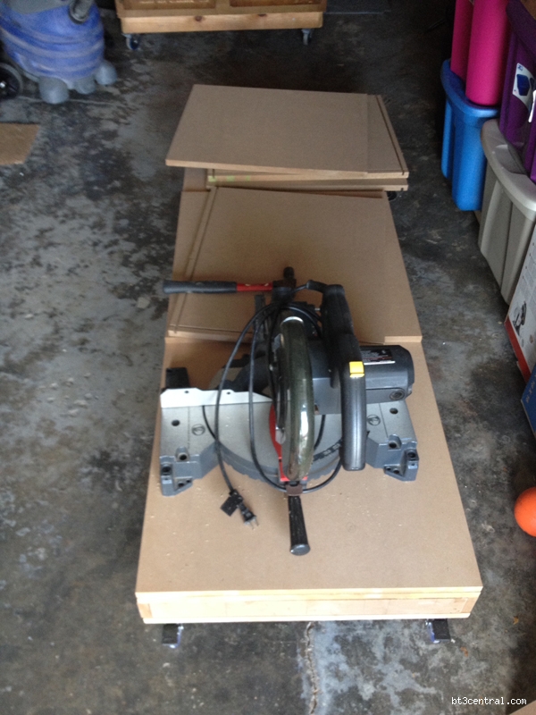

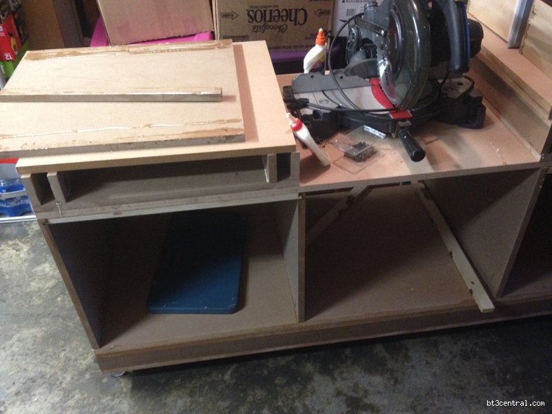

              A little more progress...
              So my son, 15, was over last night, and he never balks at an opportunity to use power tools, and I am more than willing to let him do so.
              We accomplished a little more....
              First we attached the top of the bottom cabinets and fastened them to the cleats shown in yesterday's photo.
              Then we started on the "top boxes" (which aren't going to be the top...More on that shortly).
              The tops of these are not yet attached, but the ribs are attached to the bottoms with glue and pocket screws. (for the record, I use the HF version of the pocket hole jig, and it works amazingly well! I've used if for all sorts of projects).

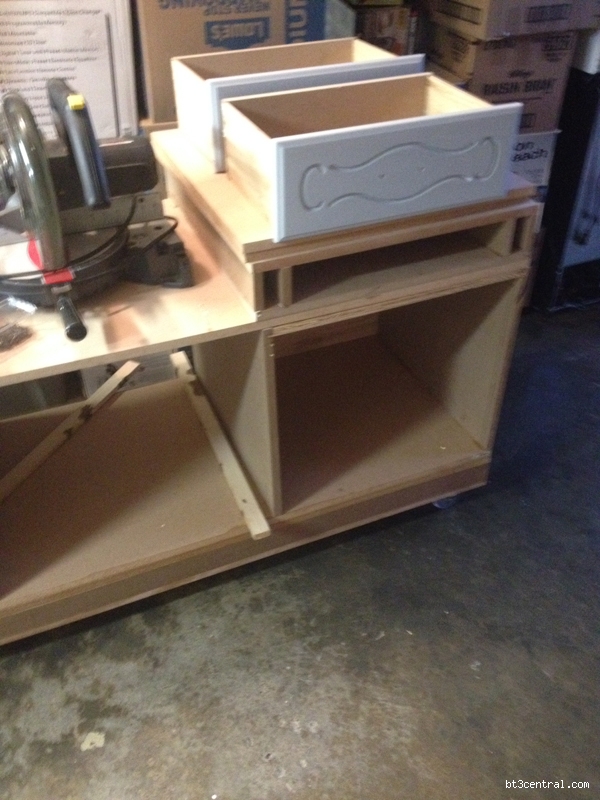

              THere are some deviations from the original design...
              First, the "side boxes" in the original design call for a set of ribs in the middle. I have opted to not put these in. I also will not be cutting slots in the tops of these as is called for by the original. This is not going to be the top layer of my UTS. There will be drawers going in both of these.
              There will also be two narrower boxes going in right beside them which will also have drawers.
              The reason this is not the top, is because it is 3 3/8 shorter than it needs to be in order to be used as an outfeed table for my BT3K. So I will be building another layer on top of this one for the finished version (as was suggested by another forum member).
              I'm thinking I will likely have the drawers accessible from both sides, but I also have considered using my soft close drawer slides I have left over from another project.
              It is a beast, though.

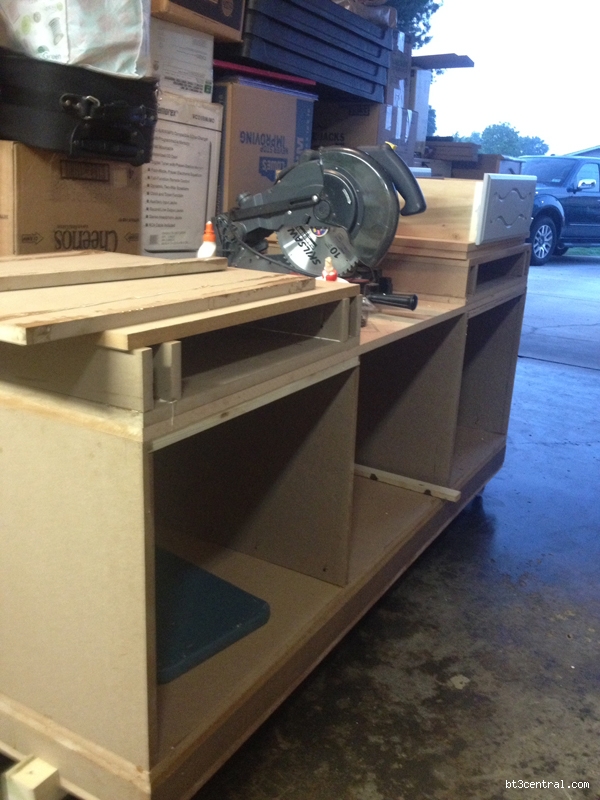

                  Progress continues, albeit slowly. This weekend was full of "other" things (graduation party, yard work....)
                  I did apply a coat of Poly to basically everything. I found it easier to go ahead and apply the poly before doing any more assembly. Some parts would be impossible to poly after assembly. I'm hoping to get some more assembly done at some point during the evenings this week.
                  Right now on the 'to do',
                  *Cut a hole in the top of the cabinet for the Router (Router table)
                  *Assemble the top boxes.
                  *make drawers to put in those boxes.
                  I'm starting to refine my designs for the "top layer" as it needs to be 3.375" taller than it will finish according to the original plans. These may have to wait until July, as the rest of this month is going to be very busy with other obligations, and saw dust time will be limited.

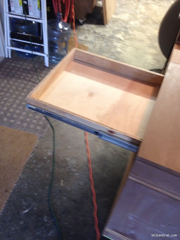

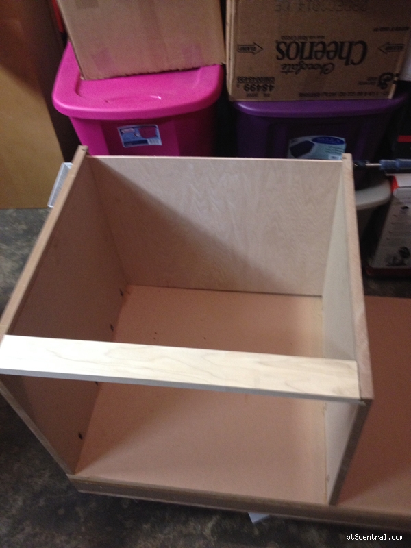

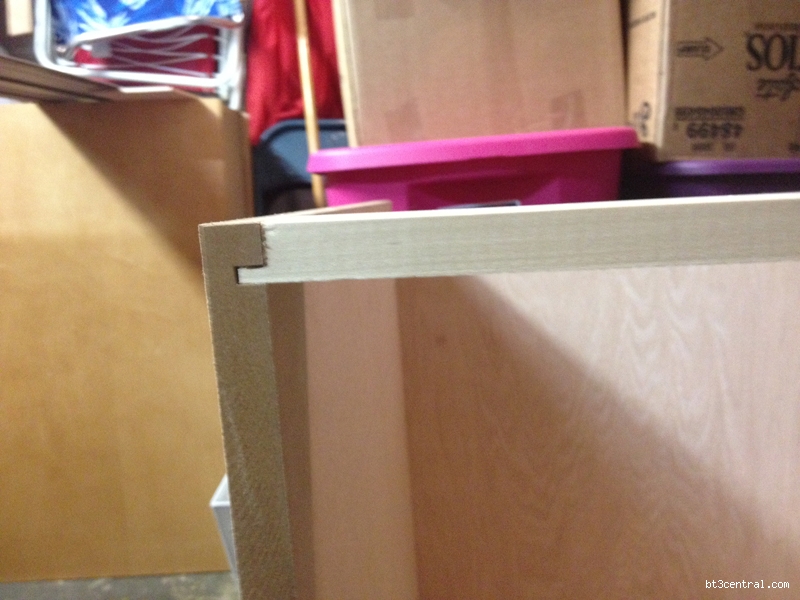

                      Progress has come to a grinding halt it seems. Other priorities have a tendency to take over at times. Yard and garden work has to get done, Other obligations for the weekends (graduations, birthday BBQ's, etc.) Once I get through June...(other projects will eat into sawdust time! )
                      Anyhow....I had some spare time last night before dark so I finished one of the two drawers for my UTS build.
                      It isn't particularly deep, but it will serve its purpose. Drawer sides are made from 1/2 ply with a 1/4 plywood bottom. I had some soft close drawer slides left over from another project (purchased 10) and used those for this.
                      Next up is finishing the assembly of the other wide drawer, and then two (very) narrow drawers for the two narrower slots. Then it is on to the design and construction of the top layer. I'm still working through some details on this as I am trying to think "long term" functionality as well.

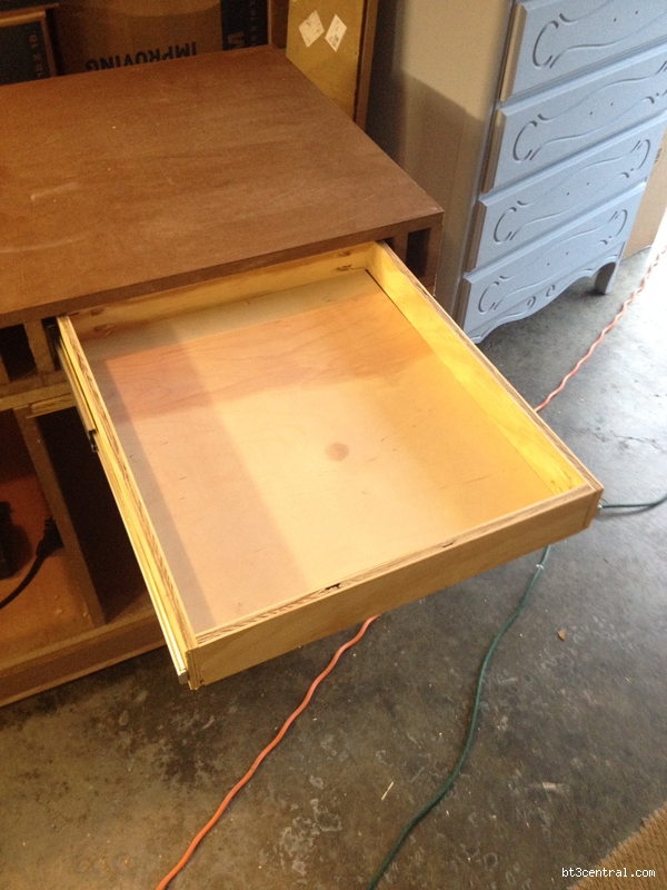

                            So I completed the other drawer over the weekned.
                            I also came to the conclusion of the heght issue. I raised my table saw 3/4" to give me a little more height for the overall workbench.
                            Now I will work on finishing he "top" section, but here is an idea of the finished height. Right now (with the parts I had previously cut) it sits 3/8" below the top of my BT3000.

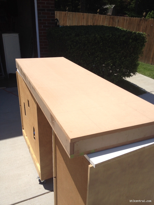

                              Work got started on the tops.
                              First order of business was to poly and sand the tops to a near finished state. The first coat of poly pretty much soaks into the MDF. Sanded that to 320 grit, and applied the second coat. That was sanded to 600 grit, and a third coat applied. Once that coat cured, I sanded again to 600. This was done in advance of the next step.
                              In my research, it was suggested that you finish the top so as to not have to sand or remedy drips in the holes.
                              To do that, I had found someone on ebay who offered CNC services for $25 per hour. I had him make a template from 1/4 aluminum, it is 12"x12" with 20mm holes on 96mm centers.
                              I first drilled out the holes with a 15mm forstner bit, and then used a 1/2" pattern cutting router bit to finish the holes.
                              It worked quite well as the holes are square to each other (using my framing square.
                              I was able to complete one "top" and have two more to go plus my router table top (all of which are poly'd and sanded.) Then I have to figure out the best way to attache them.
