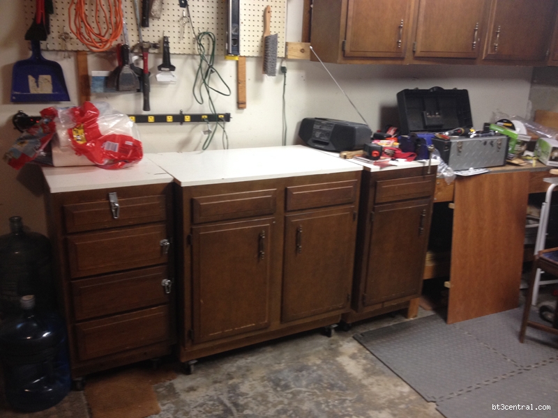

            Pictures of the finished goods...
            About two years ago, my wife and I remodeled our kitchen, which included the installation of new cabinets. We had all of the old cabinets, which I have repurposed into workshop cabinets. I put casters on them, so they can be moved around throughout the shop as mini work tables. And since they are all the same height, I can use them as a larger work surface for other things, too.
            These were the base cabinets, they included a simple 18 inch one drawer box, a 4 drawer box, and a sink base. (the wall cabinets are also used, but do not really show up in the photo). The sink base, had drawer blanks because there was a sink in it.
            One of my bright ideas was to build some drawer boxes and get some slides to add storage space to this sink base.
            So, I used some scrap 1x8's (which were already painted and used for shelving somewhere). And created 14x20x3 drawers. I had some scrap 1/4" ply so I pieced together some pieces for the bottoms (thus the seam). Total cost was the drawer slides ($10) and some screws. The drawers are constructed with toungue and groove joints. While not super tight, they were tight enough to not have much play, and were a good start for learning some things with my saw.
            I simply reattached the false fronts to the drawers to match the other cabinets and now I have more funcional storage for my shop.
