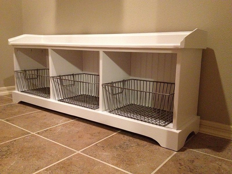

        I made this with regular 1x stock and MDF and painted it white. 1x is plenty strong enough.
        We filled the three cubbies with baskets. I'm not a fan of the baskets but my wife likes it.

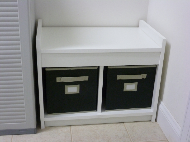

                WoW Thanks guys lots of info , it's going to take day's to look at but would like it simple like this one with out the bottom curve at the bottom planning on using baseboard on the bottom anyway , I do have a jig but never had done this.
                With something like this pic if I make it with 3/4 maple plywood with 2 "feet's" on each corner on the inside to keep it level and center brace will it be strong ? or should I go with a 2x4 bottom frame ? Just got to make strong I'm not a skinny young veteran like I use to be! My wife likes the open bottom to put shoes in .

                  That is a pretty nice looking bench, I'll have to think about making one myself. Actually, 3/4 ply uprights would be plenty strong and a 3/4 bottom self should have no problem supporting the bench. As an added precaution, you could use supports under the upright pieces (between the bottom shelf and the floor) since they will be hidden by the front piece.
                  I'm not a skinny, young whippersnapper either and would have not problem with a bench built with 3/4 ply. Good Luck.
