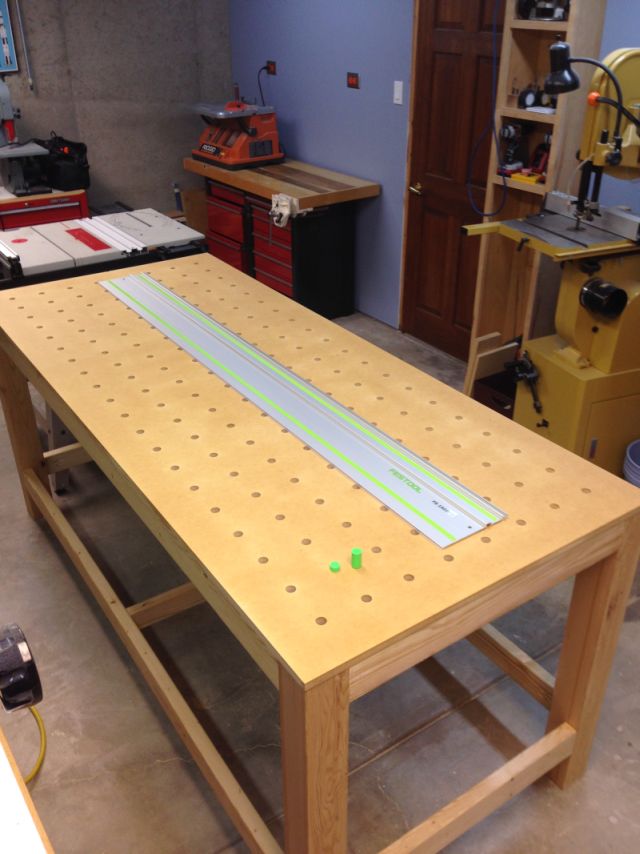

            I bought a Festool track saw a month ago, right after I finished the workbench for it. I had decided that the Festool MFT/3 worktable was too small for me (it really is designed to be portable, and I wanted a bigger stationary table). I built my own workbench. The MFT/3 top has 20mm holes in it, in a precise grid, so I CNC-machined my own top. The frame is "high quality" 4X4 and 2X4 lumber. (Seriously, though, I went to a quality building supply store/lumberyard, rather than digging thru mountains of warped lumber at the big box stores.)
            My other major goal for my new workbench was that it double as an outfeed table for my BT3100. The two are not joined, and it works just fine. I had lived with roller stands previously, and I was always moving and adjusting them. Nothing can compare to having a huge, stable outfeed table. The bench as shown still needs a vise added, and I plan to add some storage below it. After using it for about a month, I cannot imagine not having an outfeed table after using one.
            I plan to build a rolling cart for my planer, so I can roll it to the opposite end and use this bench as its outfeed table.
