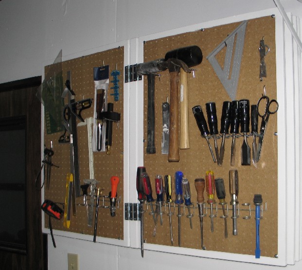

      I'd hang them vertically on the inside of cabinet doors. You could make a shallow shelf with holes for some of them, and a deeper shelf with two sets of holes (outer one for handles of the next batch of chisels, inner row that line up with the first shelf for the blades of the first batch of chisels) so there's some vertical overlap. Kinda hard to explain in words... quickie sketch attached: dark gray=door, light gray=shelves, brown+silver=chisels.
      Or imagine medium sized panels hanging on hinges arranged like the pages in a book. I have something like this in my shop, the "center spine" is just a few thick boards attached to each other; the boards get narrower as you climb the stack. This makes stairs on each side of the spine - running vertically; each panel then attaches to one of the stairs so the panels naturally hang with space between them for tools. Each panel "page" is a little less wide as it gets closer to the fixed panel on the wall to make up for the stairs. I included two pics of the pegboard panels I use in my shop. So far they've worked well. They don't have to be pegboard of course, slat-wall (French cleat) style panels would work well, as would plain flat panels with custom tool holders glued/screwed in place. I already had the pegboard on hand so that's what I used.
