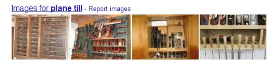

    And the use of the word tlll? similar to the slang for a cash register with its internal separated drawer, I find this in a google search:
    In the UK the term "till" is used to describe a shelf inside other form of chest, used to segregate small items. - See more at: http://www.chacha.com/question/why-d....3p6srU63.dpuf

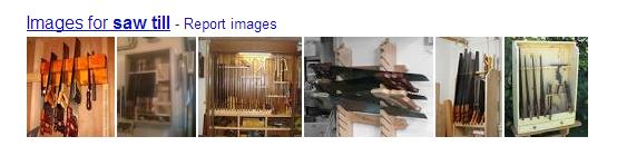

          OK, looked up plane till and saw till on google and you get vastly different answers than just looking up till. Look at the google images. So I learned something.
