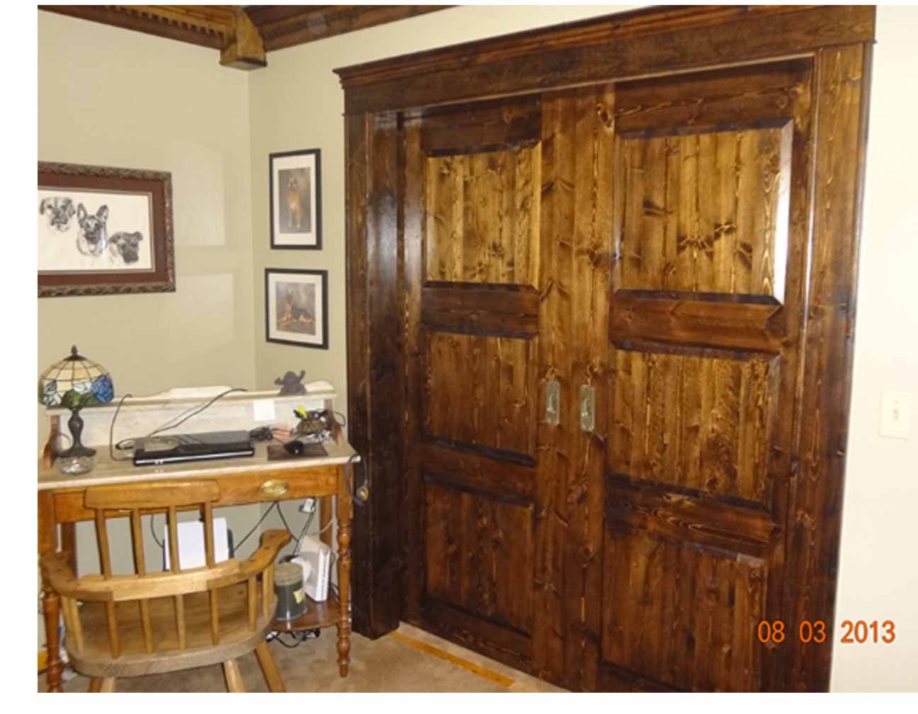

    Made some doors for the bedroom closet. Common pine, dark walnut stain and 1 coat of poly. Raised panels done on tablesaw. When I'm able to, I'll rub down the doors with steel wool and apply a couple of coats of wax. I like the softer look I get from the wax. I also made the crown moulding (same stuff) and that's throughout the house. (Still have to do baseboards.)

    Wow!!!! Willy, awesome job with common pine, awesome job with any wood for that matter! Do you have a full shot of the crown? What walnut stain did you use and how did you control blotching?
    How did ~90 people look at this and not comment

      I LIKE IT!!!!
      Very very nice!

        Chop I have to admit that I didn't even apply a sealer before I applied the stain (I would have but forgot to). There was some blotching but I've had real good results with evening out the blotches with 0000 steel wool. I don't have a shot of the moulding but I'll try to remember to shoot some tommorow.

          It looks great for Pine, Willy. Did you use a minwax stain or something else?

            Chop, I used min-wax dark walnut. I do a lot with pine because I don't have the funds for hardwoods for a project this size. I did the crown moulding, base mould and door and window frames throughout the entire house. If I used hardwoods or something more exotic I'd have to sell the house to be able to afford it. LOL

              Sweet Willy that looks fantastic. I've also made furniture out of pine and stained it walnut but mine never looked anywhere as good as yours. I used Watco danish oil.

                Looks absolutely great! Great! Well done! That makes me want to make something!

                  Very nice job, Willy.

                    That looks fantastic! Excellent job.

                      Black, I used Dark Walnut and that makes a huge difference. And if you've never tried it, try Dark Walnut on red oak. Amazing look.

                          Those doors look really great, and I thank you for making this inspiriing post.
                          I've had this old 1887 house for about seven years now and so many project that seem to be getting done all too slowly. The place needs new doors and after seeing your post and the terrific results of your craftmanship, I'm inspired to give a shot at making my own, as the cost of buying quality, factory-made doors is ridiculous IMO... even pine doors a 'veneered' these days.
                          Thanks again, great job,

                            That looks wonderful! Budget issues aside, that pine gives some great character!
                            Very warm homey feel to it...
                              Nice Job! I made pine doors for my Pittsburgh house using framing lumber and shelving boards and they came out well - at least we liked them.
