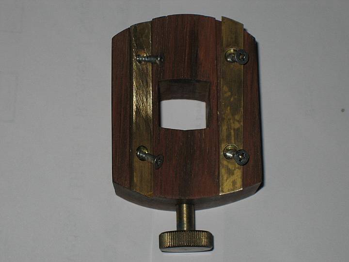

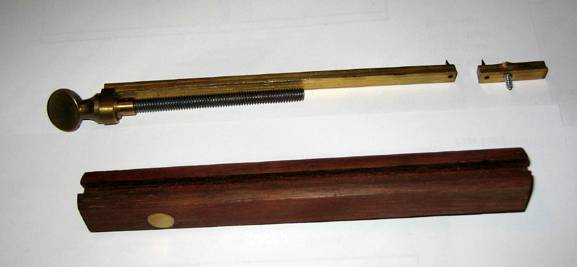

    Several months ago I bought a Marples Mortice Gauge on eBay. It was covered with blue paint. I have removed the paint (and the original finish in so doing) but now have two questions:
    1. What would you use to finish this device - polyurethane, shellac, etc.? (If you notice on the block, there is still gold paint from the original logo and I would like to save this if I can.)
    2. Should I screw the brass parts back on the wooden parts before I apply the finish or afterwards? (If I apply before screwing them back on, will that affect their seating?)
    Thanks in advance for any and all suggestions and opinions.

    polyurethane.
    polish up the brasswork, and put on after finishing. The amount it will be off will be the same if you fisinh over the brass.
    The other solution(s) if worried that the thickness of the finish will throw your measuring/marking tool off is to mask off the area where the brass fastens when finishing and then put the brass on. Or, put the brass on, mask the brass, then finish.

      I would vote for shellac. I just like the look of shellac, and it's really easy to apply, reapply, and repair.

        I would usea 1# - 1 1/2# cut shellac and wipe it on in thin coats. I refinish plane totes and knobs that way and the result is outstanding.
          I would just use a pure Tung oil.
            Test the gold paint with whatever solvent is in the finish you intend to use to make sure you won't make the logo run. That being said, I would also use shellac for the above mentioned reasons. After cleaning the brass, I truly don't see a reason why you couldn't spray right over the brass. It would protect the brass temporarily until it rubs off.

              Depending upon how you want it to look, you could touch up the decal with gold paint from the hobby shop and a fine brush. I'd vote for a coat of shellac on the wood, assemble it all and finish with a couple of light coats of lacquer. It will protect the brass and is easy to repair. You can get pretty good clear in a rattle can at the big box stores. If you have access to it, my favorite is Koenig with Mohawk/Behlen right behind.

                Thanks to all who replied. I had originally considered tung oil but wondered about frequent reapplication. Then I considered shellac but was afraid the ethanol base would dissolve the gold paint. I'm afraid lacquer would do the same. That is when I considered water-based poly but wondered if it would be too thick on the brass. So I posted on here to get opinions. Still haven't made up my mind but may try a few things to see how they react to the gold paint. Again, thanks to all.
