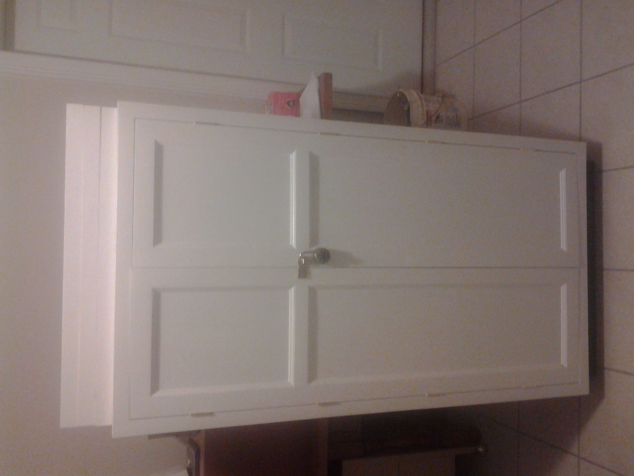

    I've been off work (mostly, still do some email) for over 2 weeks now. I made Christmas dinner for 7 and did some other entertaining but I have also squeezed in some small shop projects. I made a cabinet for my church using my new DeWalt track saw. It is 5 foot tall, 16 inches deep with three shelves. The main body is from one sheet of 3/4 BC plywood. 5mm luan back with the outside painted white, the base (of 2x4 scraps) painted black and the interior left unfinished.

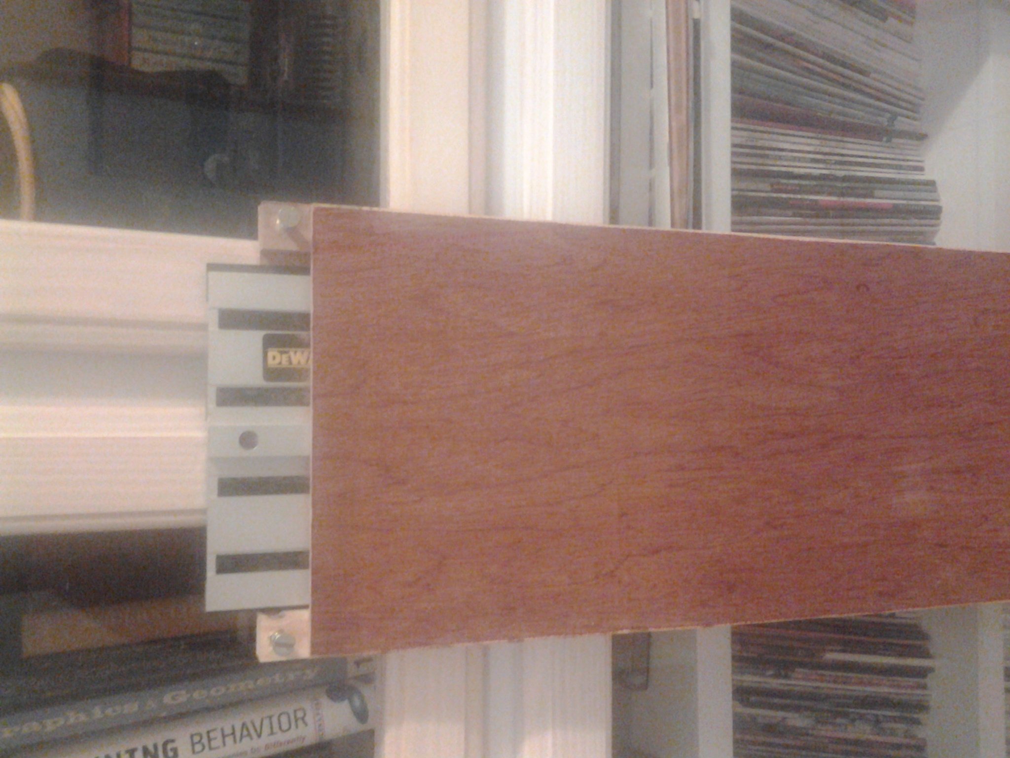

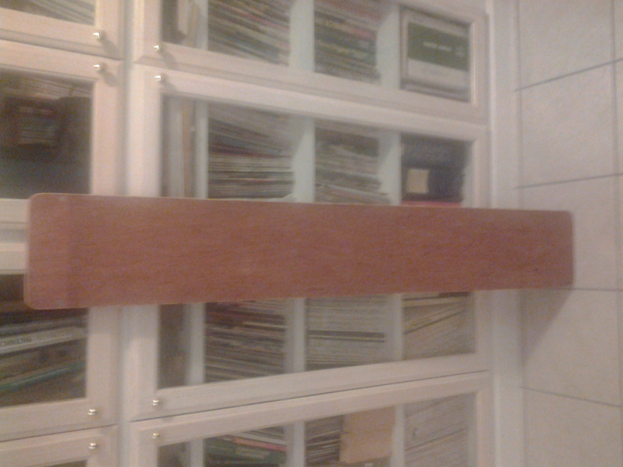

    The next project was cases for the guides for my track saw. The 102 inch guide came with a masonite box but I don't love masonite, it is not glued together, just stapled, and if you push the guide in all the way, it is hard to get back out. The 59 inch guide came in a cardboard box with a 1/8 masonite stiffener. The new cases are made of 5mm luan and 1inch by 1/2 thick scrap pieces of hardwood and softwood. It is fastened together with glue and pin nails. I made the cases so 1 inch of the guide sticks out with the end cap removed. The end caps are held on by 1/4 inch x 3/4 inch flathead machine screws that go into 1/4 threaded inserts installed into the solid wood edges of the case. If I made the long one again, I would put the extra length piece of luan at the end opposite the end cap and run the softwood full length except for the end cap. That would better support the guide than what I did which was to put the extra 8-9 inches into the end cap.

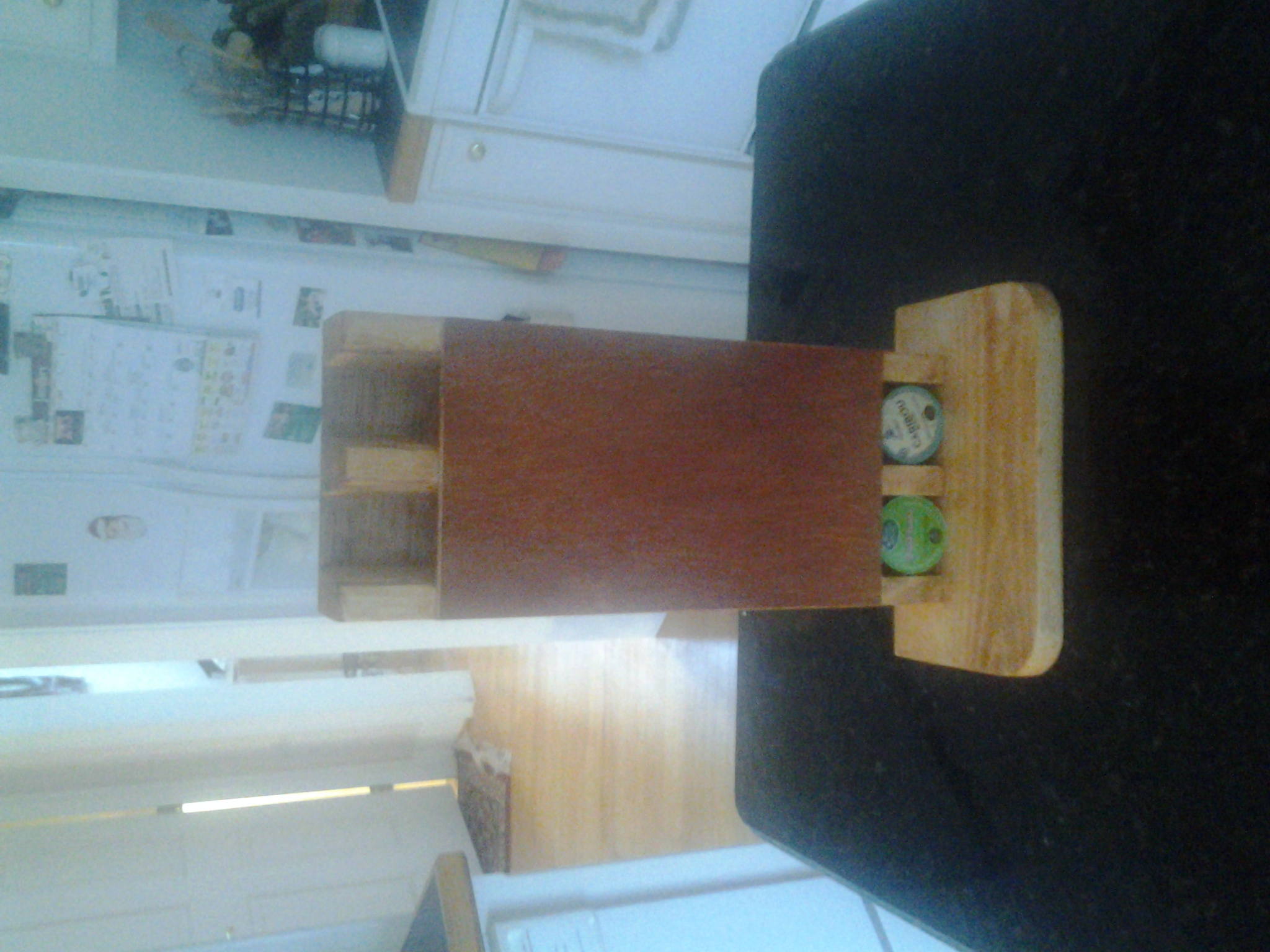

    The last project is a simple stand for K-cups. The only slightly challenging thing was making angled inserts so the cups come out facing out. HInt - cut at 6 degrees and use 1 1/2 inch scrap.
