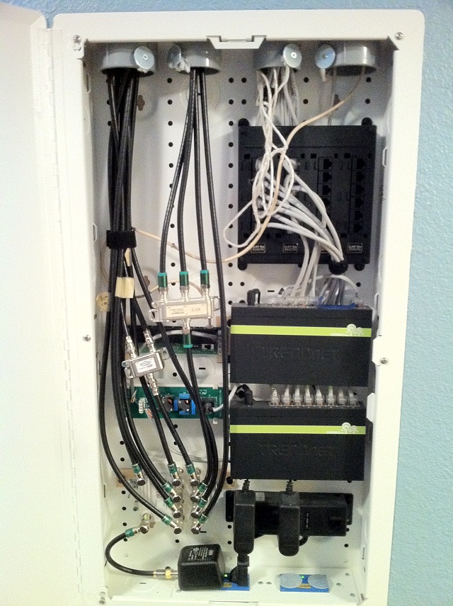

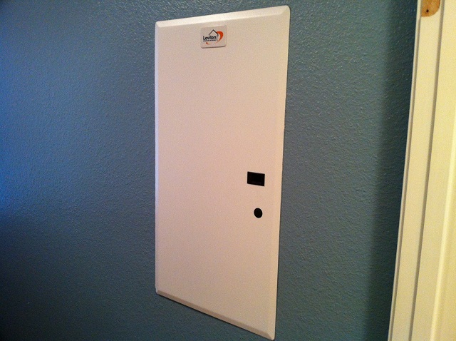

                    I'm using a 28" structured wiring enclosure:
                    http://www.smarthome.com/865109E/Lev...ncluded/p.aspx
                    It's got two 8 Gigabit switches
                    This splitter (I got off of ebay for way cheaper):
                    http://www.amazon.com/8-Port-Bi-Dire...705795-2858753
                    24 port patch panel:
                    http://www.smarthome.com/36546/Levit...e-ports/p.aspx
                    A DSL filter board and a phone module similar to this:
                    http://www.homedepot.com/buy/leviton...l#.UKUvoVEzra4

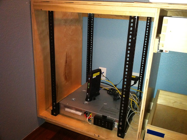

                    I then made a custom rack to hold my rack-mount UPS and it will eventually hold my media server as well.

                      Wow, while not quite what I am looking for, I think... that looks great. A couple of quick questions...
                      #1. This is just me being curious. But why did you opt for 2 8 port switches instead of a single 16 port model? Mind you, I have 2 of those exact 8 port gigabit switches, but I am using them for an iSCSI SAN implementation that is set up actually on a desktop.
                      #2. Is there a way to perhaps mount the switch / switches on a plate that could hinge down 90 degrees thus allowing view to the status LEDs without having to crane ones neck?
                      #3. What is the required mounting depth? Can this be mounted say inside a standard 2x4 wall stud cavity?
                      #4. How are the devices actually attached to the enclosure?
                      #5. What are the interior dimensions of this thing?
                      #6. The patch panel, does it use keystones, or is it more of a solid punch down block on the back?
                      IF I can make everything fit excluding the UPS, I can provide at the very least conditioned power through the surge supressor that it looks like you added as well. That would leave me with very little else to worry about on this installation. I could install it on the wall that gets covered by the bedroom door when its open, so it is no less intrusive than say an interior mount breaker panel. I see yours has a key hole. Does it include a locking mechanism?
                      • ivwshane
                        • 446
                        • Sacramento CA
                        I used 2 8 port switches because of cost and space. Both switched cost me about $40-50.
                        There are all sorts of mounting brackets available but you could also make your own and buy the locking buttons to hold it in place.
                        Yep, it's designed specifically to be mounted in between 2x4 studs 16" oc.
                        Push in locking buttons. Smarthome.com should have a bag of them.
                        The link in my post should have the demensions but they also make a 48" version if you want more space./
                        Keystone for the front and standard punch down in the back.
                        You can use a standard lock on it (it did not come with it) but I have no need nor do I want more keys
                        Personally I'd go for a whole home surge protector. The surge protector in my enclosure really isn't a surge protector but rather an extension block, however that is plugged into an AC module that has power protection.
                        http://www.smarthome.com/865110/Levi...r-Block/p.aspx
